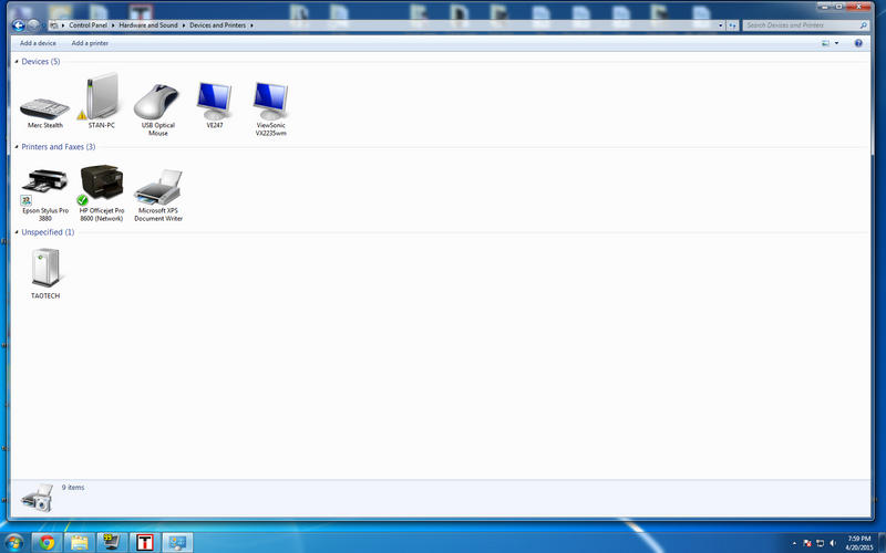

3-I have installed the"TitanJet Epson Print control software" and the software said the driver installed correctly. It does show under "Device Manager" as "TaoTech printer" under "Universal Serial Bus controllers". However it does not show under "Devices and Printers" instead it shows under "Unspecified" (As shown in the pictures) Is this normal?

I don't know about Tjets but I do have some experience with printers. I have never installed a large printer like a regular windows device. If you do install a driver like that, it only lets it work like a desktop printer and you cannot really do large format stuff. Some printers have desktop drivers for their printers, but that is not what you need. Rips on the other hand install the printer from within the rip software, and they only are seen from that program. There is no trace of them in windows printers or devices etc...
You need a rip to install your printer. Did you not get a rip with the printer? If I were you, I would try to get the Flexisign rip that I have seen available for the TJets. Unless you know of another quality rip program that will drive your printer...
