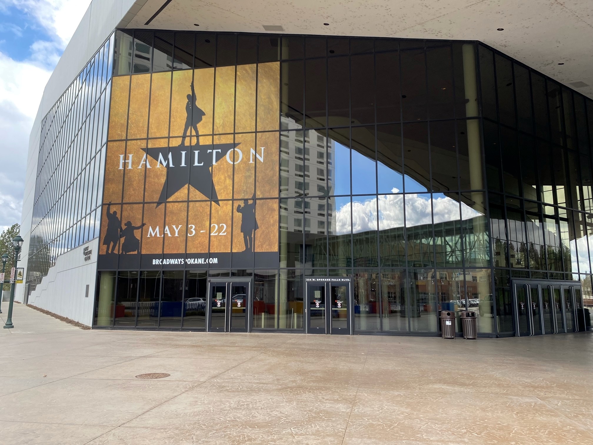

We are going to be needing about 3 rolls, and none of our suppliers have in stock - or it's 5 months out. Time is of the essence. Can anyone recommend a source, or a viable alternative? This is for window graphics for a Broadway show. We will need laminate too.

open to other brands. We would like translucent, but it needs to be removable. They fill a giant window bank for a performing arts center, and with the translucent, it looks awesome from the inside as well. We may have to go with opaque and a clear adhesive. My boss is still looking at options, but we need to move on this soon.

You might be fine using an "opaque" material. We had a print on IJ180 applied to a rear side window of a car and the sunlight would shine thru it like it was translucent. The window even had a dark tint too. Every time I saw it, I was surprised how well the light shone thru it.
Actually looking at our front glass door we have our logo done with opaque Gerber 220 vinyl and the light is shining thru showing the same color inside and out.
Boudica
Thanks JBurton! I passed this along to my boss, and we are going to try it. Bonus, our local supplier stocks it. the low tac and clear adhesive is just the ticket - and with the clear adhesive it won't be truly opaque. It's as good as it's gonna get anyway.
Boudica
Arlon has some a similar white, never used it, just fits the bill.
arlon.com/na_en/products/dpf-50wd-white
Alternately what about a white window cling? Translucent, removable (if a little too removable), clear adhesive... I got a sample in from nekoosa I still haven't tried out.
Thanks for the lead on material JBurton ! It was installed today :u rock:

I changed it from first place to like. Only because it just went up, and it doesn't have as much tac as what we were using. So we'll see how it holds up.

It's still up, and it looks terrific from the inside too. I'll let y'all know how the removal goes
