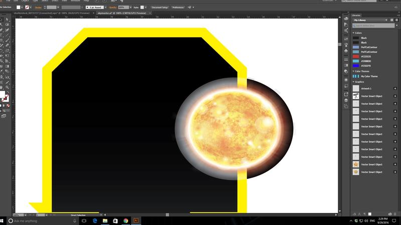

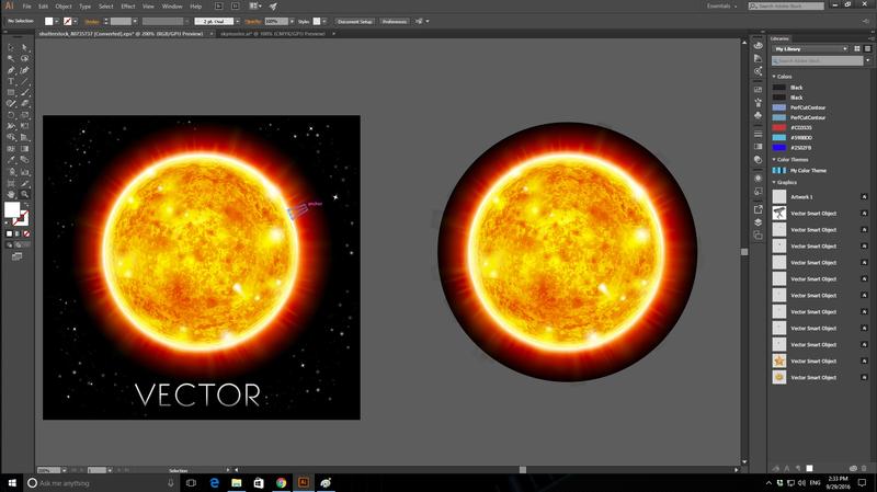

Sorry for the delay in replying back. Life kind of got in the way. Here is a picture of the vector in illustrator. I put a copy of the sun next to the one with the background for reference of what it looked like when I put it with the shape. The other one is of the sun half on the shape and half off. When zoomed out the shape is actually filled with a gradient. I did reset the essentials prior to these.
attachment.php
attachment.php

You're taking an image that was built in RGB and transferring it to CMYK. This completely screws up any transparency and colors. I've been driven mad by this process too.
The only real solution I've found is to resize the object you want in the RGB file, then flatten it. You won't be able to easily adjust it in in the CMYK file, but it shouldn't do a major color shift on you.
oksigns
Nah. Not RGB/CYMK issue.. without seeing the actual file.. I would have to say it is actually the blending mode under the Transparency panel. You would have to rebuild/repurpose that sun for your needs unless you flatten it and edit it in Photoshop.

It is a RGB vs CMYK issue. Once I changed my drawing to RGB then it works fine. Thanks! I have been fighting with it for some time now!
