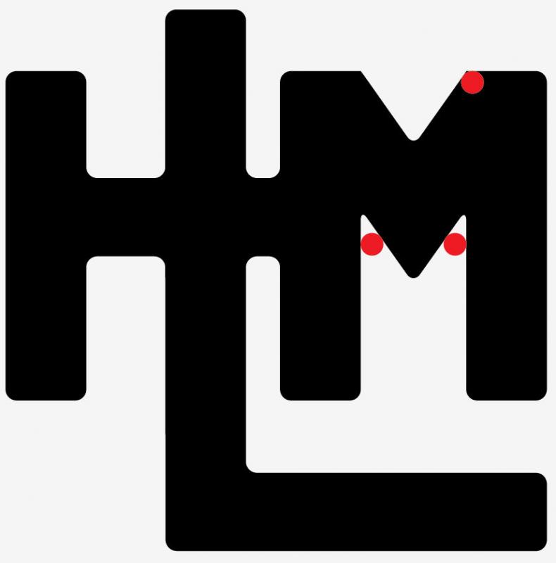

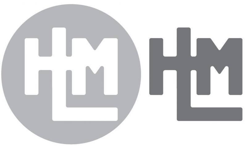

I want to rout some letters to inset into a routed space in another material.
Right now I have a shape with sharp corners.
As the other CNC guys (& anyone who's thought about it) would know, if I use a 1/4" bit, I will have a 1/8" radius on all my inside corners. & on the negative space, that would be the opposite corners from on the letters...
So, I want to modify my file to contain a 1/8" radius on all corners.
I've heard people discuss different software that has tools to make this easy to do. I've never needed this tool, so I don't recall anything about which software has that capability, or how to do it.
I'll start checking the help menu. but wanted to fire this post up here first, since this is where I first heard about it being possible.
Thanks.

I was reasonable successful with the CS4 method.
all my 90˚ corners worked properly (except 1 ?)
but the obtuse & acute angles in my M did not.
I fixed them with a little node editing, but I might experiment with Flexi & Enroute later.
