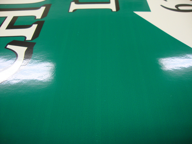

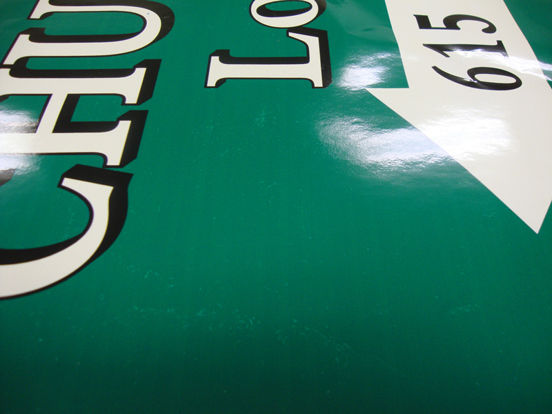

I know it must be difficult to figure a printers problem, but there has to be someone who can get my mimaki jv3-130spII to print like it did a month ago. A month ago the printer started having drop outs on greens, I sent pics to the guy I have been using....he thought I needed a new black head but knew money was tight for me and suggested just switching out the yellow and black heads, but he wouldnt be able to get out here for 2 weeks. so I called another company I have dealt with and they sent their guy out. He said switching it would just cause another problem...he did a bunch of tests, recalibrated...it was a bit better but not fixed...cost $575. So I am thinking screw it...did some finaggling, bought a new head and had my regular tech guy come out today. He worked on it for 5 hours...was on the phone with mimaki...determined, not the head, not the encoder strip, the bar is not warped, it's not the heater...he thinks it's flexi. Cost $750. But I just printed something thru raster link and the same streaks are coming thru!

You have any pictures of the problem your having?
yes....attached is the print from the rasterlink rip (1st) and 2nd is from flex. On the first print...there must have been dust on the end of the roll ...which is what those dots are...the streaks is what concerns me. On the flexi I printed slow unidirectional. Thank you.

try lowering the heads and printing in unidirectional 8 pass and no high speed.
what heat settings did you use? what vinyl is it? does it have the thick backing paper or the thin stuff. Also try printing on Matte. Not sure why but my jv3 likes matte

I have it on thin....i guess there is another way to lower the heads? I am printing on lg 5 year....but on the avery MPI 1005....its even worse. We have a vehicle partial wrap and you guessed it, GREEN...looks horrible. We usally print at 35 and 38 degrees but we have been trying all kinds of temperatures to see if this would aleviate the problem...it does not. Now I did have some paper posters we did earlier that were green...and it was not nearly as bad.

How many passes are you doing?
How big is the banding?
Have you done a print adjust? (aligning bi-direction print) It looks like your bi-directional could be out.
What is the print resolution and what dither type are you using?

Test draw is good...dampers are good...both techs realigned/recalibrated (thats the same right?) Printing at 720, 8 pass, dither FMX press.

Have you considered the media? If it worked a while back and the issue is present from both RIP software programs, seems like the RIP is not an issue.
What version of Flexi? Have you checked your Rendering Intents and possibly use the Pure Hue options to test?
Maybe even try a similar profile?
Possible Humidity/Static issues?

it was actually printed on lg 5yr. on any vinyl...from avery to the orajet...same issue. Only thng we dont have a problem with printing is paper
and banners.
