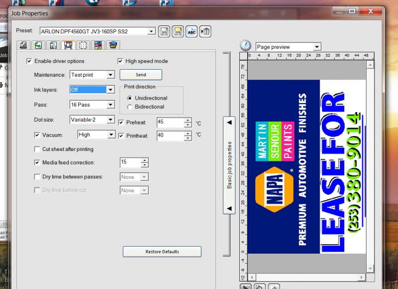

I have the option to do ink layers...2 times , 3 times etc......then uder that is 4 pass 8 pass 16 pass........would I put the ink layers on 2 and the pass at 16 or just 8...and ink layer at 2 or just one layer with 16 pass????????? wow confusing
tooserious

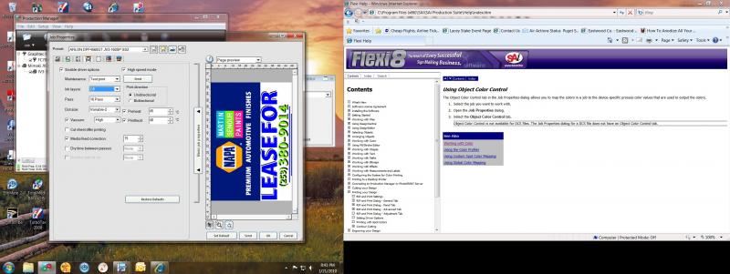

Here is the prod manager screen the ink layers is on off but can be set to 2 times 3 etc what is optimal for translucent vinyl

I would do 2 layers & try 8 pass.
No advice can take the place of running some test prints though.
If you don't have some white plex & the means to simulate a light box,
I suggest you get one.
