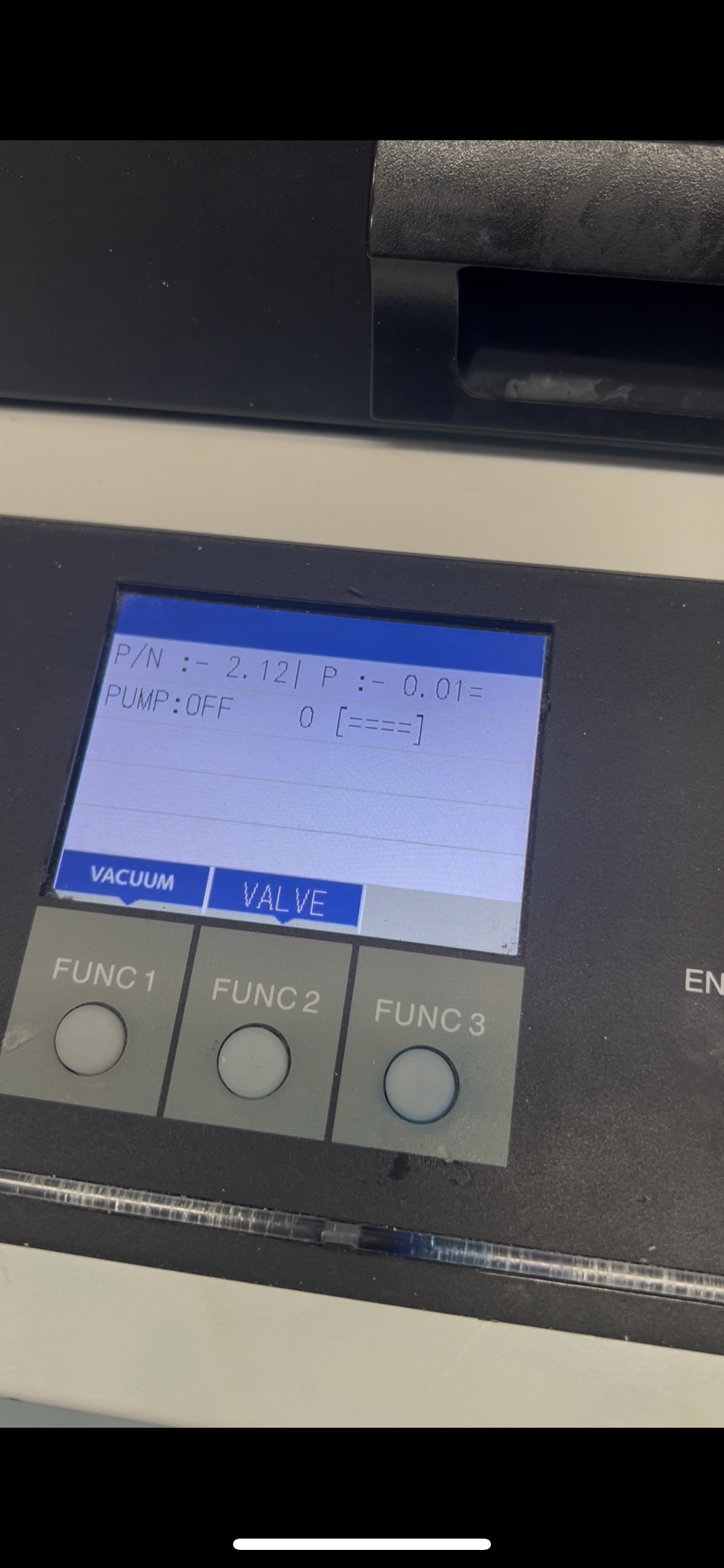

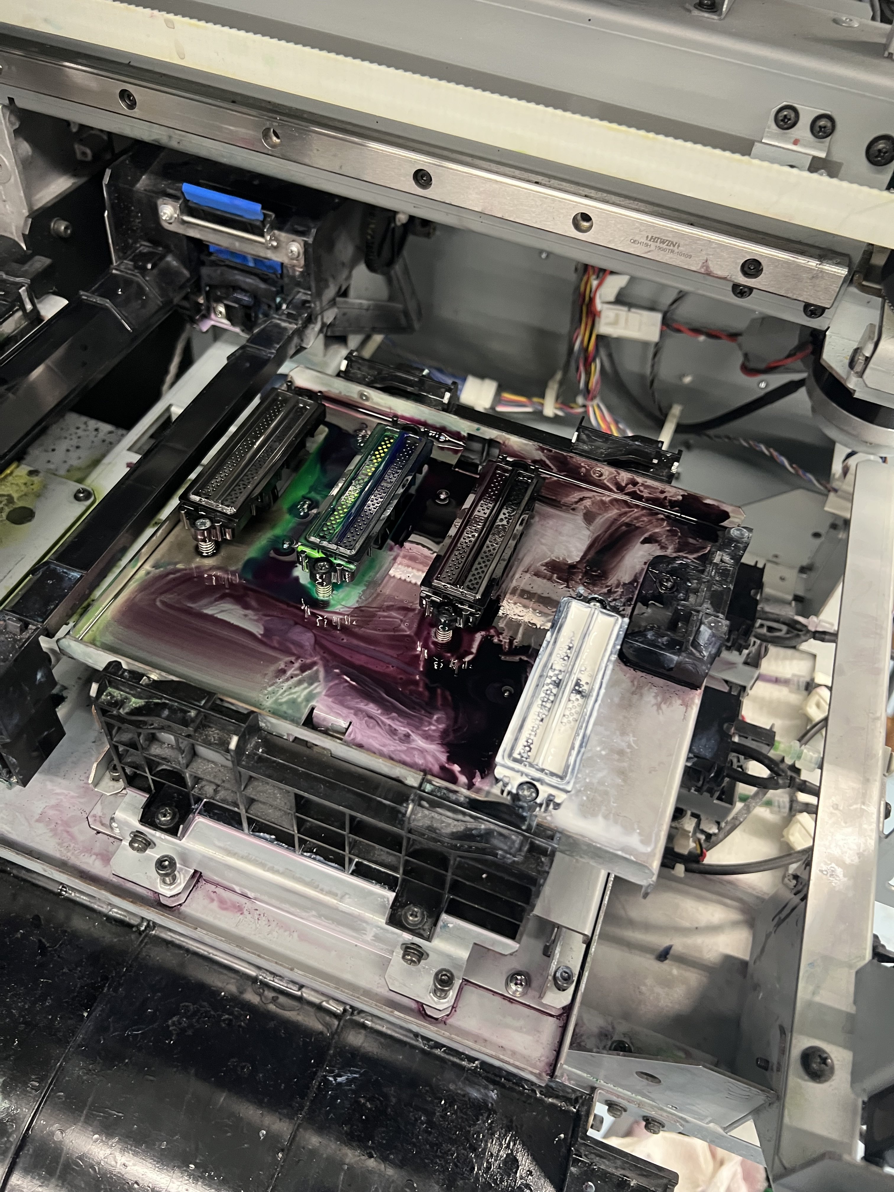

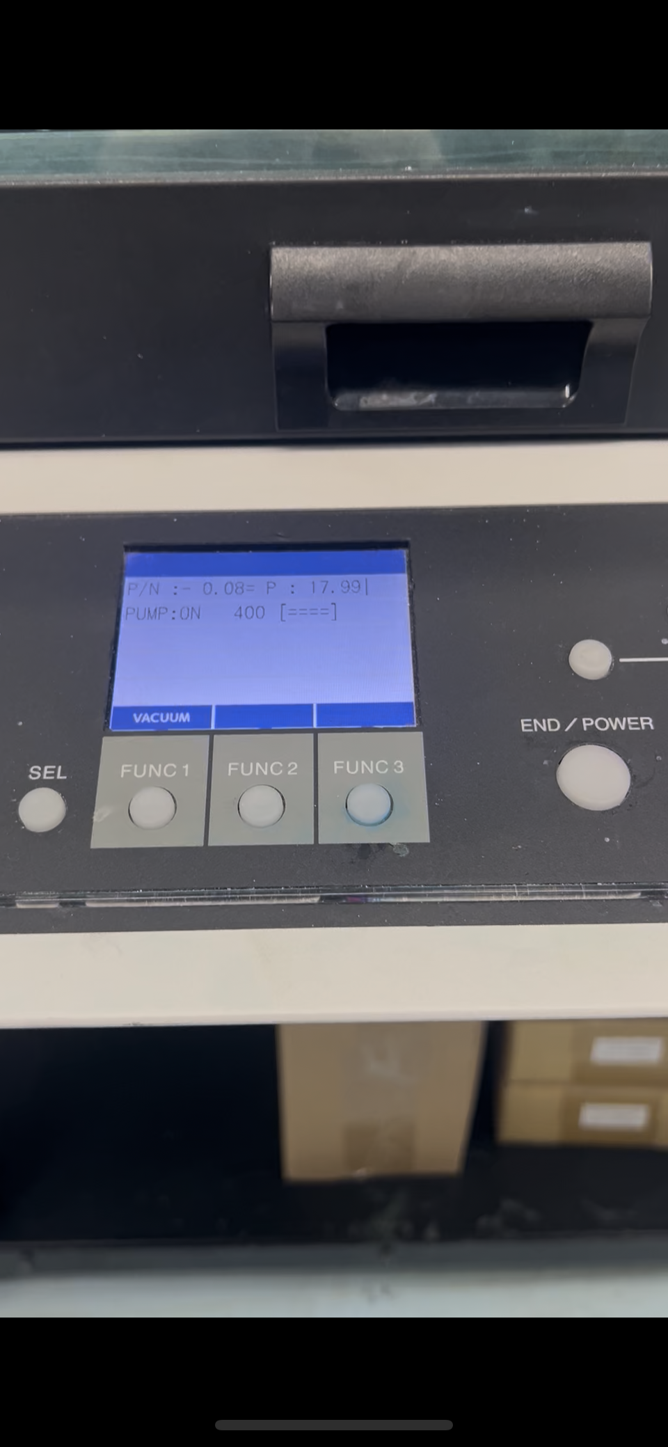

I replaced two subtanks (black&magenta). Performed a fill tank then started having leaking from all print heads down into the caps. I also periodically had 61d error while the ink was circulating and turning on the machine. I replaced those two subtanks again with new ones and had the same issue. Checked pressure in #adjust menu and pressures for positive and negative were within range. I checked all connections and everything looks ok to me. I read that the rubber seals need to be fat side down, which I did not do. Would this really cause that issue that ink is leaking from all heads?
My next steps were to try to replace the subtanks again with the old ones and also turn the rubber seals the correct way. Anyone have any ideas what’s going on to cause leaking from all tanks? I should also note I do have about 10% or less of ink left in the bottles. Not sure if this is also an issue.
