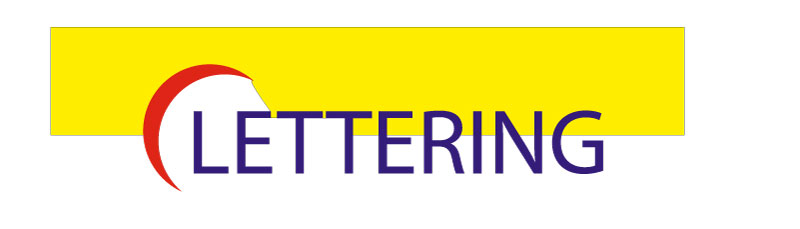

Make a 50% pattern that runs from the edge of the door to the other edge.
I would even suggest making it out of phototex or something similar.. for easy re-use
