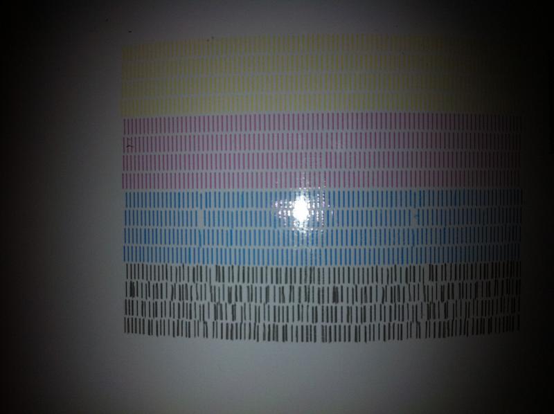

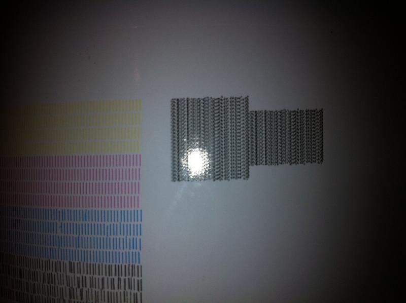

Hey, how's everyone doing? Hope everyone is well. I was curious if you guys think it's time for a new print head judging by this test print. I noticed that the blue seems to be a little off too, do you think i need two new print heads?
Also, i'm getting a little bit of overspray and the edges aren't as crisp as they once were on prints, would this be related to needing a new print head?

Looks like you definitely need to replace that head. Lot of deflection in the black. From the looks of the test print i'd say this is an SP series. Since that's the case, youre in luck (kinda) because the black/cyan share a head on this machine.

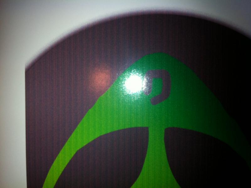

Jeremy, thanks for the response and good news haha Yes it is an SP and i was curious what your thoughts are on the overspray and non crisp edges, related to the print head you think? Attached are some prints from today and they look terrible as you can see but i don't understand why there is as much streaking as there is. Any ideas? I calibrated the printer before printing again. Any feedback would be much appreciated.

Attached are the prints I was referring to.
Thanks for the feedback.
