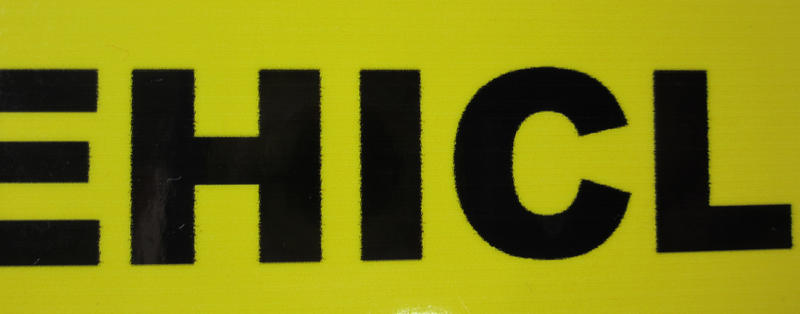

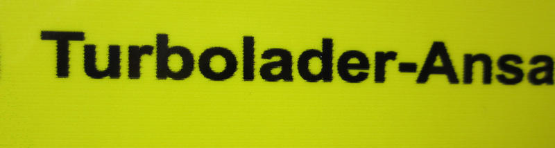

Hi everyone,
sorry for my very bad english. Hop i can refresh my english in this forum too :smile:

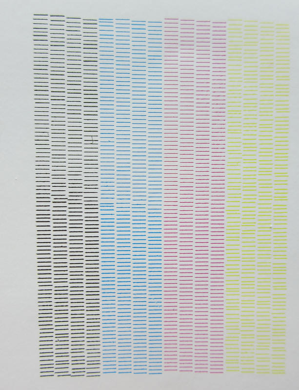

I im wondering because the nozzle-test is not to bad - is it?
But printing black is horror. I always have "scraggy" prints in letters and so on.
It doesn't matter if i print uni / bisectional or in standard / high quality. It is always
the same looking.
The other colours a very good. Cyan too!
The bad printing is since nearly 4 or 6 weeks now.
Cleaning was made hundred times, also manually.
Is my black-cyan head dead and needs to replaced? :omg:
Greets from germany..... Gnarly

Looking at your sample pics, it may not be just the black. Typically, black in a print is not just black ink, but CMYK. Look at the over spray with a magnifying glass and you will probably see that it is made up of CMYK dots. Your nozzle test has some issues, but it's not too bad. Have you tried cleaning the encoder strip on your printer?

Is it just me, or does the sample print (black text on yellow) look like the ink has bled from being too wet? If your temps are too low or you're putting down more ink than the media can handle, the ink will not cure in the drop position and bleed out exactly like that.
player
^ Good call.
What material? ICC Profile? Temperature? RIP?
What does it look like printed just black on white?
Gnarly
I played a lot around with different media settings and ICC Profiles. It's always the same.
Just black on white looks the same too.
My heating configuration is beetween 42 an 45 Grad Celsius.
Material is Standard Vinyl (Orajet 3951 or 3550)
RIP Software is Versaworks.

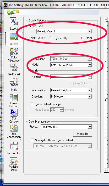

I have a trick for you to try and see if you image prints any better, in VW under quality settings select "Generic Vinyl III" which is High Quality, then change the MODE from CMYK (v) to CMYL (v) W-PASS. The "MODE"
This will slow the print head down and produce a much better resolution print, give it a try and let see if anything changes.

Thanks for the Tip. I will trie it immediately.
