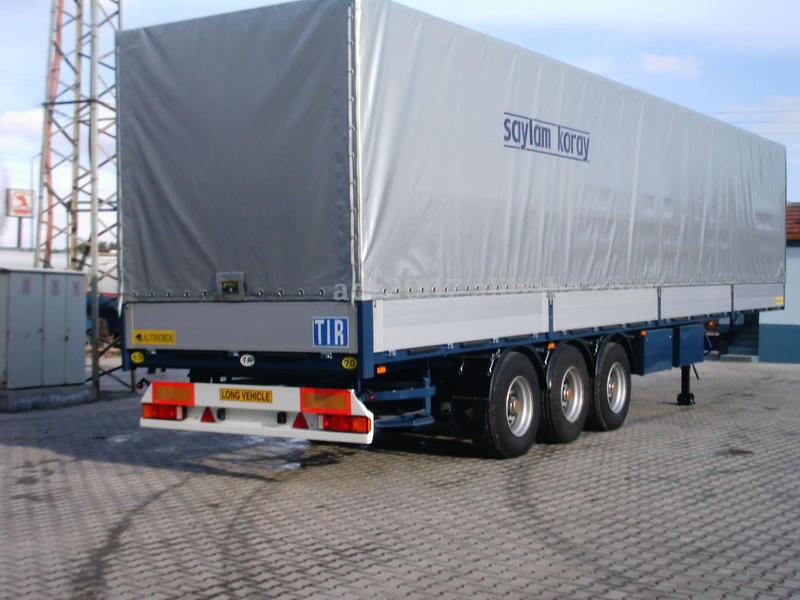

I have a customer that will need logos on the "truck trailer covers" (canvas looking material or tarp)
Is there a special material for those? Or in other words, how do you put a logo on something like that?
Also, would that be the same thing as putting logo on awnings?
attachment.php
Something like on the picture.

The only thing I have ever used on awnings was Thermo Banner. They are usually not shiny though.
Here we go:
ThermoBanner 2™ can be heat transferred at low temperatures with very little pressure, so application is possible with hand irons and heat guns.ThermoBanner 2™ exhibits the same great durability with a polyester backing for easier weeding!
Available in White, Black, Red, Orange, Yellow, Blue, Green, and Brown.
Excellent Outdoow Durability.
Great for Awnings, Banners, Tents, Tire Covers, Umbrellas, Truck Side Curtains, and more.
