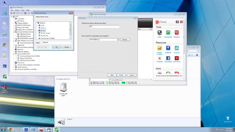

hello everyone my names Greg and i have this issue with my plotter/computer/software i recently switched computers. i have a vinyl express r series ii r31 plotter with lxi cloud software. everything worked perfectly on my old desktop but it was just getting out dated, i purchased a new computer and reinstalled everything as i did with my other one. my problem with this one is im not getting a com port choice option when asked to make a choice only a ftdiusbport 0 or 1 option and neither of those work, i have attached a picture to show the problem well tried to attach one,
any help would be appreciated thank you
i have installed all the drivers reinstalling software etc, and i am running windows 7 as well

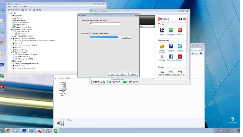

i am connected with a usb cable it comes up in the device manager as com3 but in the production manager it doesnt show up as com port it comes up with the ftdiusb port when i try to search it only shows me network options.
