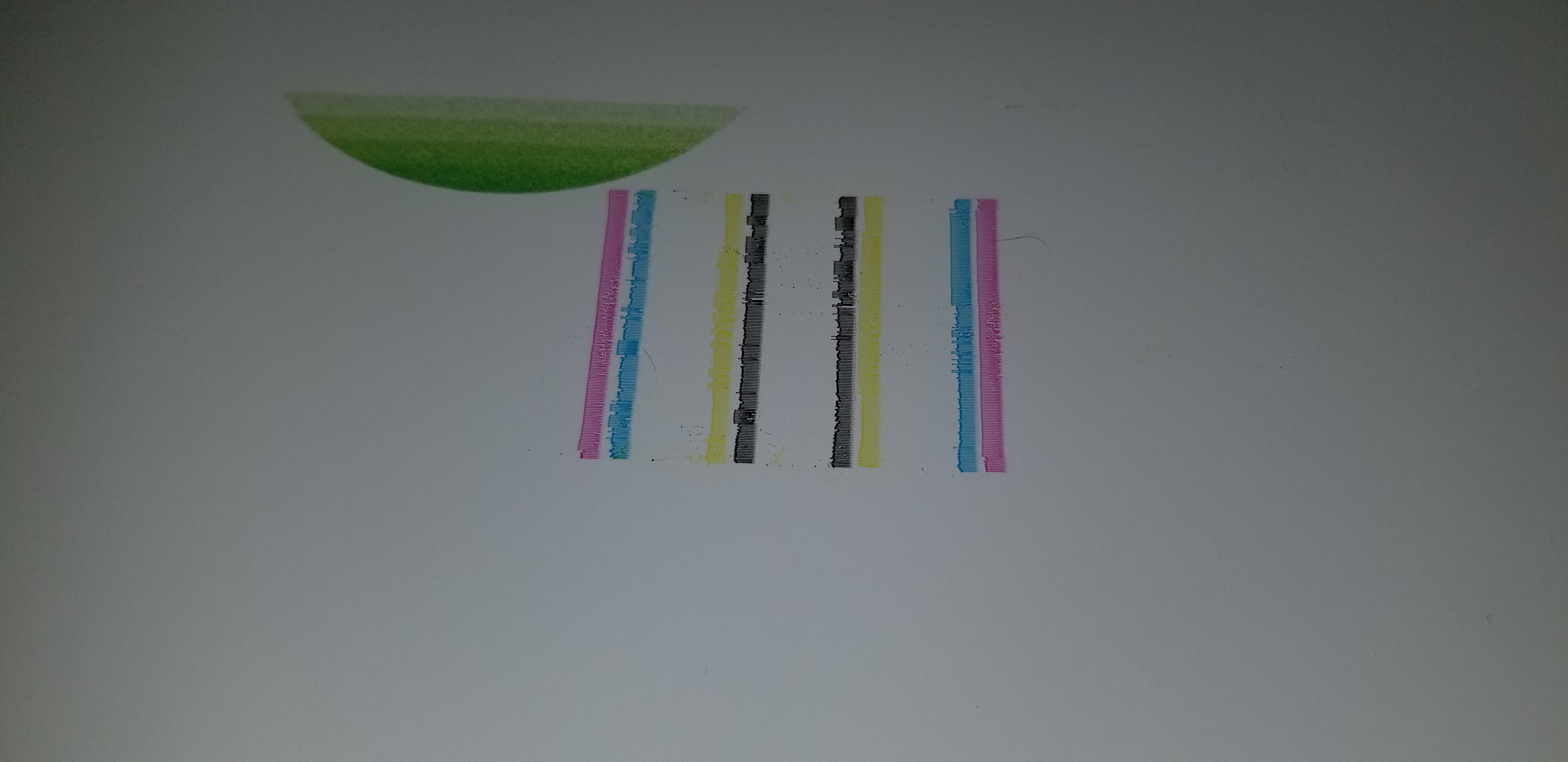

I have an odd issue on the JV150-130. Basically at the same spot almost every time. It misfires. All positions just kind a spray. It could be immediately into the print it can be 6" up the print. But generally its in the same spot. I have been working with the guys over at SolventInk Jet. It was printing absolutely fine with the new head I purchased from them and now its doing this.
Here is what I have done:
-Re RIP the file
-Try different known good file
-checked USB Cable
-used a different usb cable
-printed with flexi
-printed with rasterlink
-checked for dust in connectors on slider board and head
-disconnected all head cables and reconnected
-disconnected all slider cables and reconnected at both ends
-replaced encoder strip
-replaced slider board to main board cables "trailing cables"
*currently waiting on head cables - should be here today

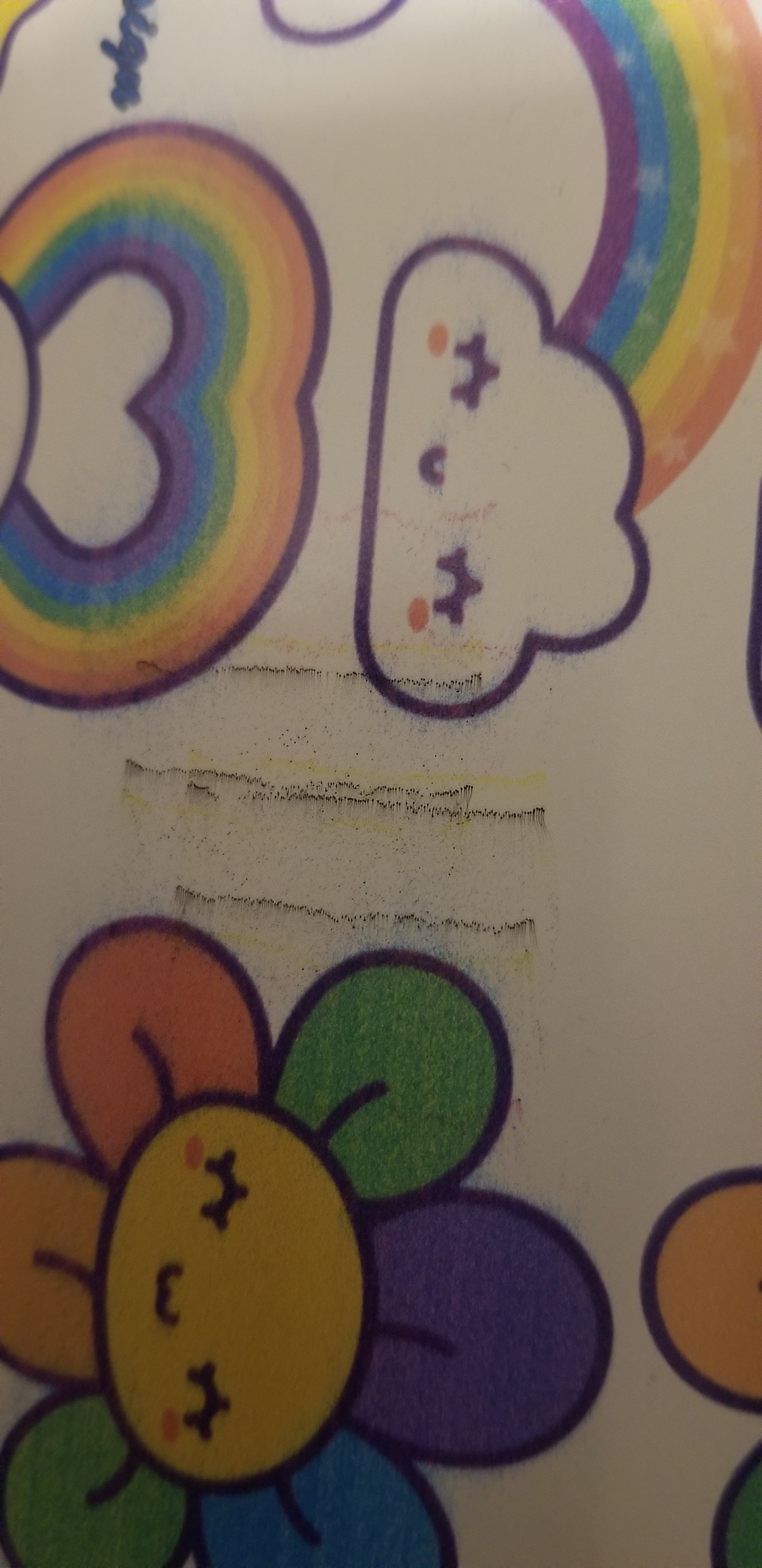

See the images below. The first is the worst one I have seen.
The second image is generally how it looks, 99% of the time its on the further end of the machine which is why I replaced things that move. Occasionally 1 or 2 times it was at the other end towards the capping station.
After it does this the print is pretty bad with streaking and not coloring in the lines so to speak. Just want to see if anyone else seen this. Still plan on working with SolventInk Jet guys as they have been great. Going to replace the head cables today when they get here. Anybody got any ideas. Next might be slider board or mainboard?
