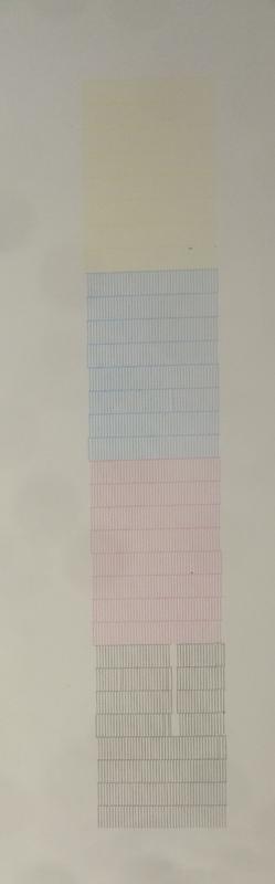

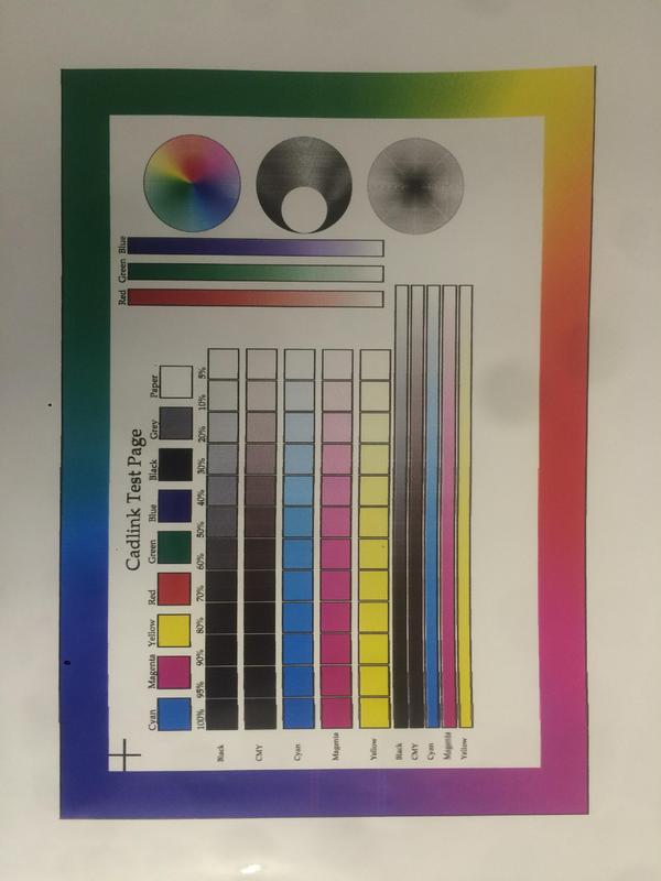

Take a pic of your nozzle check before and after the print, as well as the print showing the issue.

Hi Thank you both for replying. Here is the test draw before, the test print, the tes
t draw affter.

Replace your capping station screws with recess-mount screws. They are damaging your print heads; your black head is already ruined.
I cannot see much in the sample print photo besides banding caused by the missing nozzles, so I assume that is what you are referring to.

Thank you, I know the screws have already been replaced. The previous owner did this. There are two faults with the test print, the first is the lines are out and the sharp back lines around each box look jagged. The second fault is the lines running through the print, hard to see on the pic but if you look at the colour on the bottom you can see two lines one near the word cyan and one near the word yellow. This is showing pretty bad on some of the print I have for customers.
