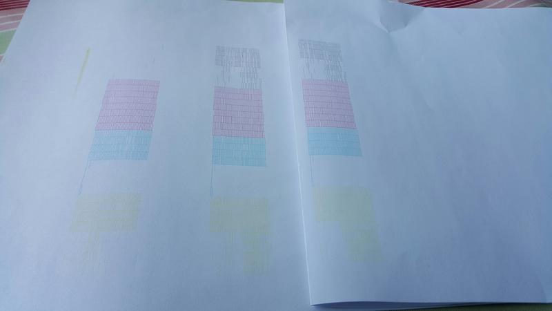

Ive just purchased a 2nd Hand Mimaki JV3 -SP2 and its my first format printer and has been a interesting journey so far!! I go through a few head cleans and have done test prints the picture attached is the latest done this morning I just wondered if I could get feedback on what should I check.
Be good to hear from people that still may use this machine.

Seems like the black head was gone.
Change new head cable and damper of it, clear it again, if test print still like this.
You have to get a new head.
I just buy two JV3 heads as $660 each this week.
