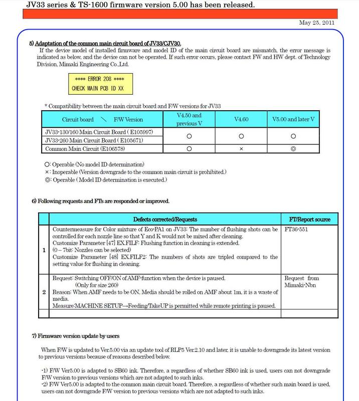

has anyone had any personal experience with downgrading a new mimaki jv33 (2011 Chinese made model) using the new mainboard E106578.
I have a 2009 Japan model with the original mainboard E105997 and have successfully downgraded this to firmware 2.2
i am scared of bricking the mainboard so I thought I would post to see if anyone has done this. It's currently running firmware 5.3 on the E106578.
also, another question, is it possible on this 2011 model to simply replace the mainboard only to an older one E105997? Or will this not work? As I have a spare mainboard which I could try.
