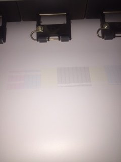

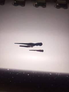

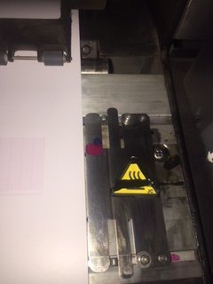

came into shop today and saw that my printer was leaving banding....new printhead only 1 week old so i did the usual cleanings and soak and still missing alot of them.....its also leaving ink as it is moving back and forth over the edge holder for material as well as almost like its got excessive ink on head....any idea or fix pics are below and im losing it over here

my concern is that when i do cleaning the nozzles are jumping around....i will do a cleaning then a section to the right that was there will be missing and so on....its a new print head 1 week old i make sure to clean it every couple days correctly and im getting nothing .... also no idea how to pull like you were saying but it just cleaned again and now its much less......for some reaon there is a pool of ink when running across media what is that from...i believe its the main cause of the nozzles happening
k.a.s.
I usually change cheapest parts first, the pool of ink I would guess might be a damper issue. Change the cap and dampers and see if that fixes it.

Although the photos are not very clear (very small) here are a couple things to look at:
1) I see you're in York, PA. Our weather (Gettysburg) this past few weeks has caused us issues too. It's not warm enough for air conditioning to run, and not quite cold enough for the heat to kick on, so our shop is not "regulating" the internal climate correctly. What is happening with the black ink on the paper, is due to MOISTURE. As the paper heats up, it is buckling up. For us, this is only occurring for about the first 12" or so of the print - until the pre-print, and printer heat catches up... and then it settles down.
2) There MAY be a small piece of fiber, from your cotton swabs, still holding onto the heads after cleaning. It can be just enough to keep the ink "globbed up", and dripping across the print.
3) Check your Wiper for excess goo. It may not be wiping thoroughly.
4) Do you clean around your heads thoroughly enough?

If you place a dry paper towel onto a head, (if you have a good print paper, it's even better) you can see if there are still missing ink dots.

NOW, for a scary thought. I noticed that there were complete 1/8" sections of color that were missing, instead of the standard "few lines each" on your print tests.
