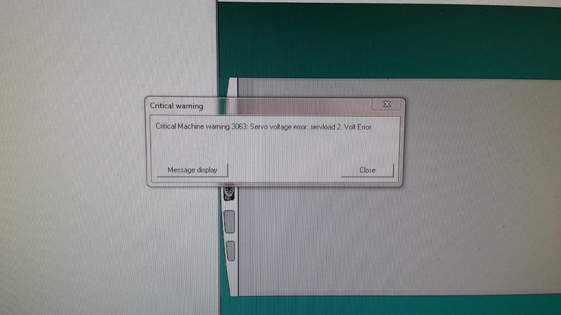

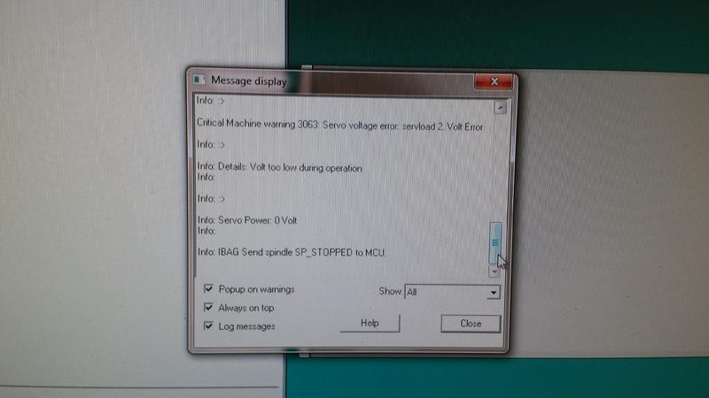

Ok just to share information. The end problem with the machine was the SSR (Solid State Relay) which is on the MPU(Main Power Unit) of the kongsberg. It eventually fried itself so I had to order a new MPU and install it. I would take pictures of the board but I sent it back to Esko before I thought of it. I will say that I smelled the thing trying to fry itself for several hours before I actually saw smoke off of the board. Just know that I was not running the machine in this condition, because well it wouldn't let me.
The board is very easy to install all the cables are labeled so it makes it virtually impossible to mess it up.
