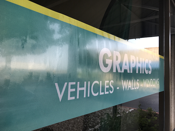

So I used Oraguard 290-GF and it came out awful. When I installed, there are streaks. I've attached a pic of what it looks like. What did I do wrong?

Did you apply dry with a felt squeegee? Can't apply wet with lammed perf cuz the fluid gets stuck in the holes. Also I've found a regular squeegee can scuff the lam.
ams
Looks like either a laminating issue or pressing too hard and the laminate stuck to the glass.

those streaks are from your squeegee. its hard to do without getting those. soft even pressure and even strokes help. but the good news is, they tend to go away after its been in the sun a while.
if you work it slow and easy with a soft squeegee i tend to not get the marks that bad.

I have found that using a bill collector instead of a squeegee has helped to avoid that. If you press too hard with a squeegee, you tend to get that "wet look". If you don't have one yet, make sure to get the bill collector. I have about 10 of them at my shop and in the few months I've had them, I'd be willing to bet it saved me about 50 hours of work.
