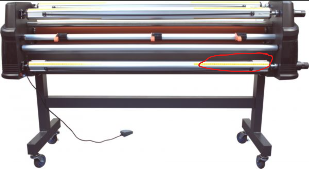

More than likely it is what Royal Sovereign called the Frequency Generator. It is a common fail part on the Sigmonts. It should be located in the area that I have circled in the attached image.
  • Frequency Generator - Generations.pdf

The frequency changer is what actually runs the motor that moves the rollers. When it fails the unit will not spin at all.
