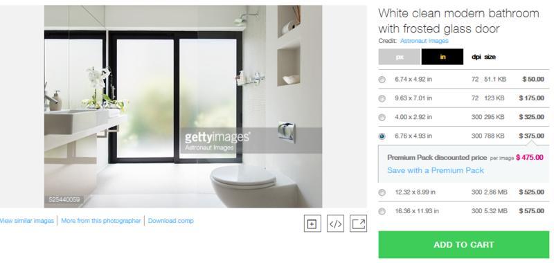

OK, showing my ignorance here. None of the sites I've been looking at say the mp size or dpi.
How do I know? I think at this point, the customer wouldn't mind paying $100 for the picture, as long as it's the right one.

for example, on getty images:
attachment.php
you can view inches as well, but it's pretty standard on these sites to see what the dimensions/resolution are
