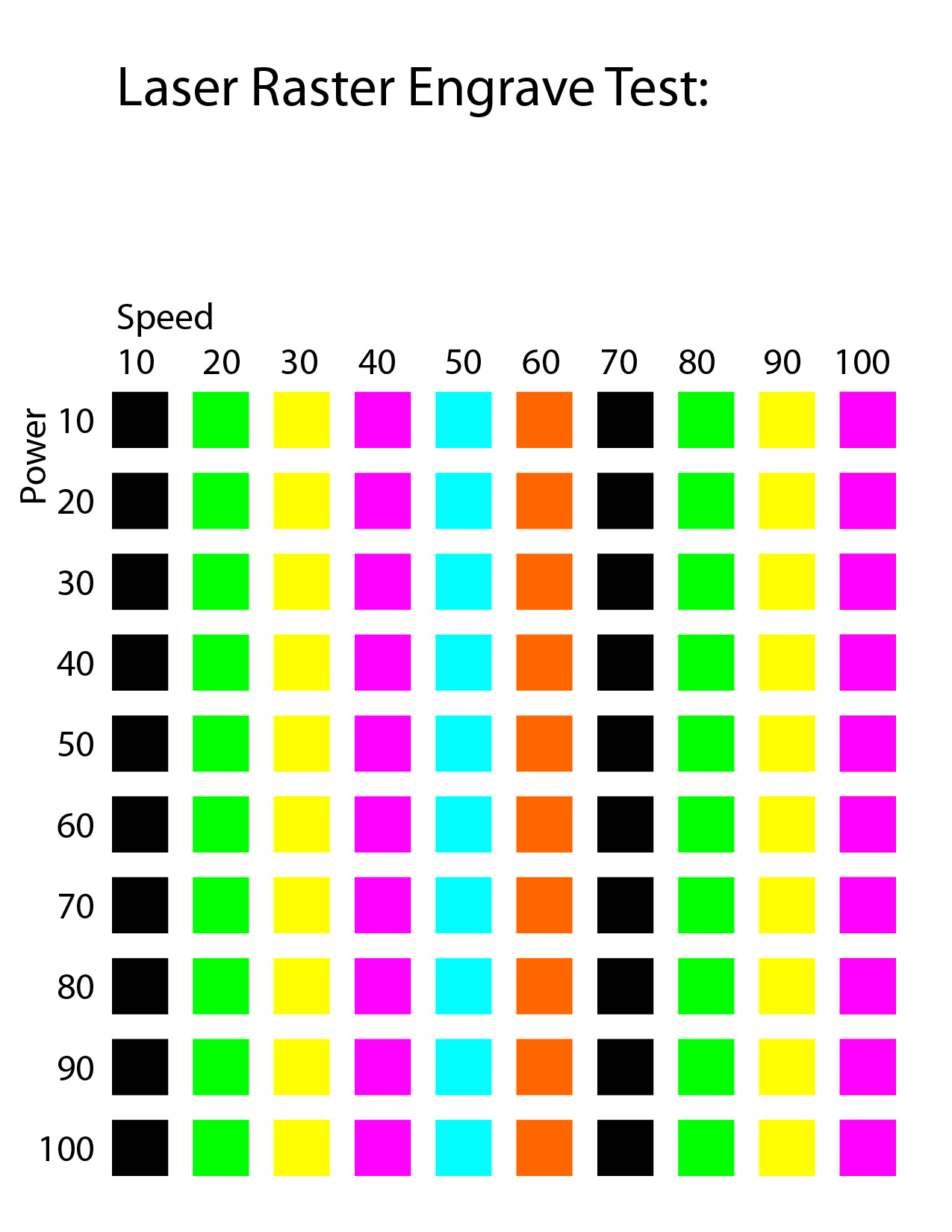

If you check the manufacturer's websites of the products you are using, they usually will have good information regarding what settings to use and how to best work with their products. Your settings will be very specific to your particular machine and if you really want to know what works then perhaps the best thing to do is to run a sample test sheet like this for each material you are commonly using:
So, what you do is adjust your settings to correspond to the columns and rows on the chart, you may have to run the test in a couple of passes since you are limited to the number of different settings you can have in one pass. In the end, you should be able to zero in on the most optimal combination of speed and power. By the way, that is only an image, so don't try actually using it, send me your email if you'd like the actual files.

Thanks for the info - I have already done notations on different materials and get good results, I was just trying to find a way to push the limits. it was suggested that I run a raster at 100% power and 70% speed with 500 ppi - did a test on Gemini duet xt and raster was not good - left about 20% artifacts.
I will test again at a slightly higher speed and power than 65% power 50% speed just to fine tune - just wondering if the ppi factors into the equation.
