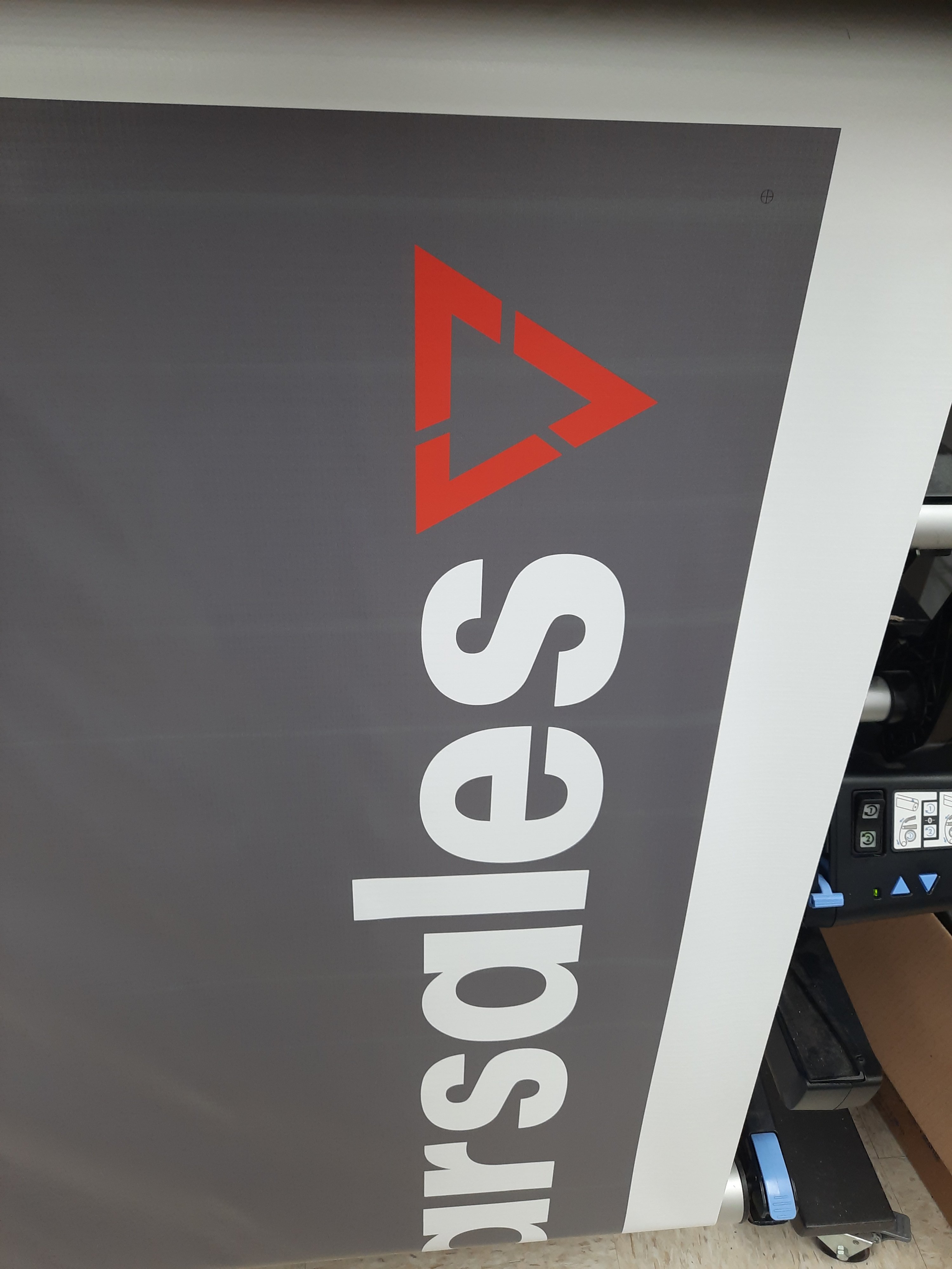

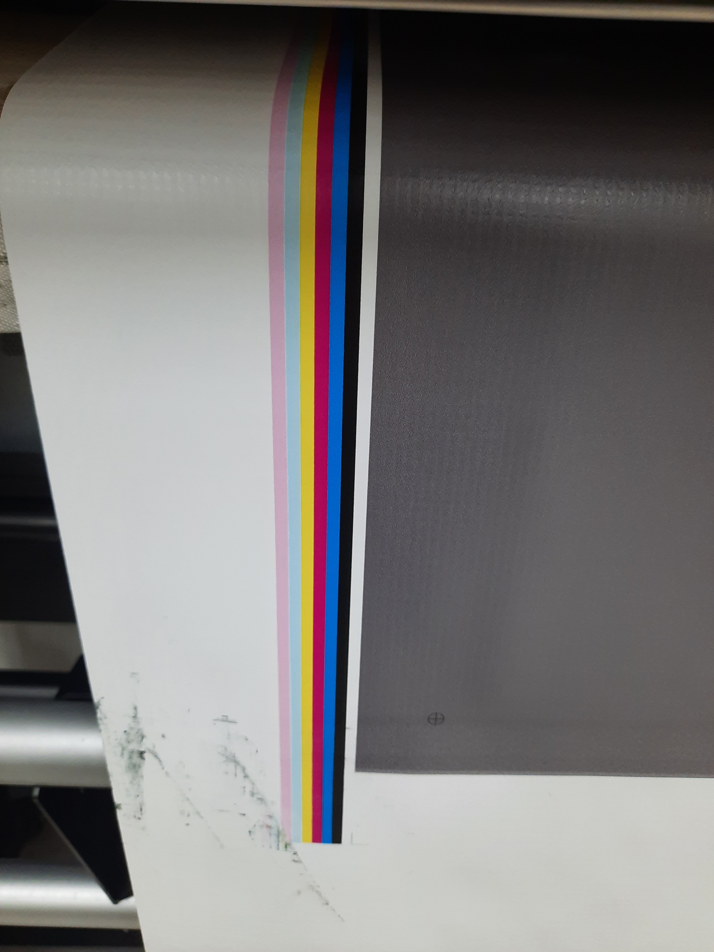

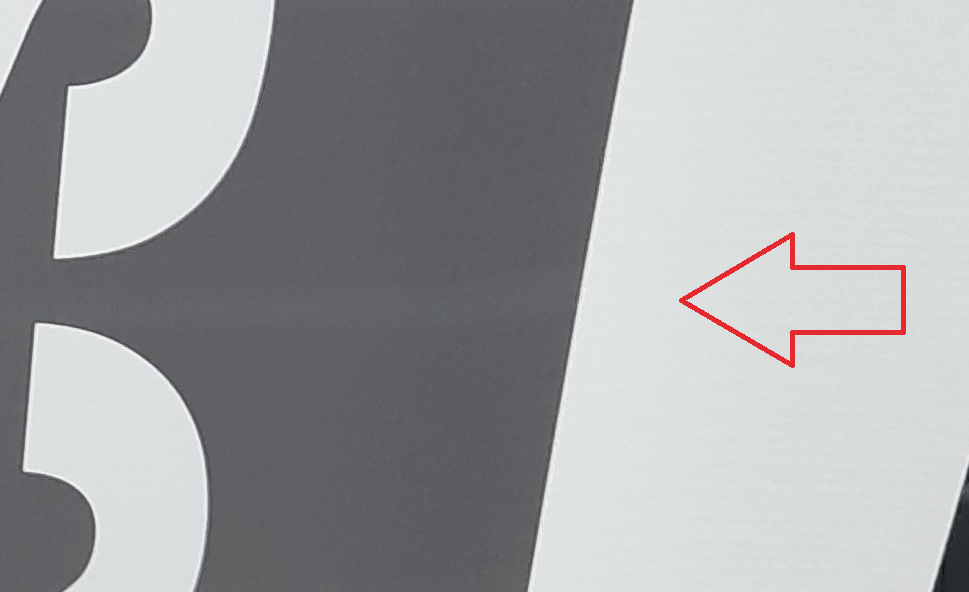

Hi,
I've been having two issues with a gray print on PVC banner. I have a lighter colored vertical stripe and horizontal green stripes. I tried color calibration, print head alignments and cleanings. I've printed on other material and haven't noticed this issue. I tried a couple different banner profiles but they all print the same. Any suggestions? Right now I am switching out my cyan and black print heads to see if it makes a difference

Both of those are purely printhead problems.
You can add spit bars on the side if you try to wanna figure out more from which channel it comes from.
But clearly you have issues with that bottom black printhead. Clean the connectors well when you put the new ones in.

No, not that problem. Some people call it ink starvation, I'm not sure if it's technically that but anyway it happens when you print certain shade and one of the heads (usually the LM-LC) has to work hard but it will not print properly after cleaning. It will start firing normal but it takes a moment. That's why you see those stripes starting from the display side and most of the time they disappear before the left side.
Now maybe in these pictures you have two different issues and possibly two different heads acting up. Not sure.
Then you print something else and the printhead doesn't have to work so hard, it stays normal and everything seems fine.

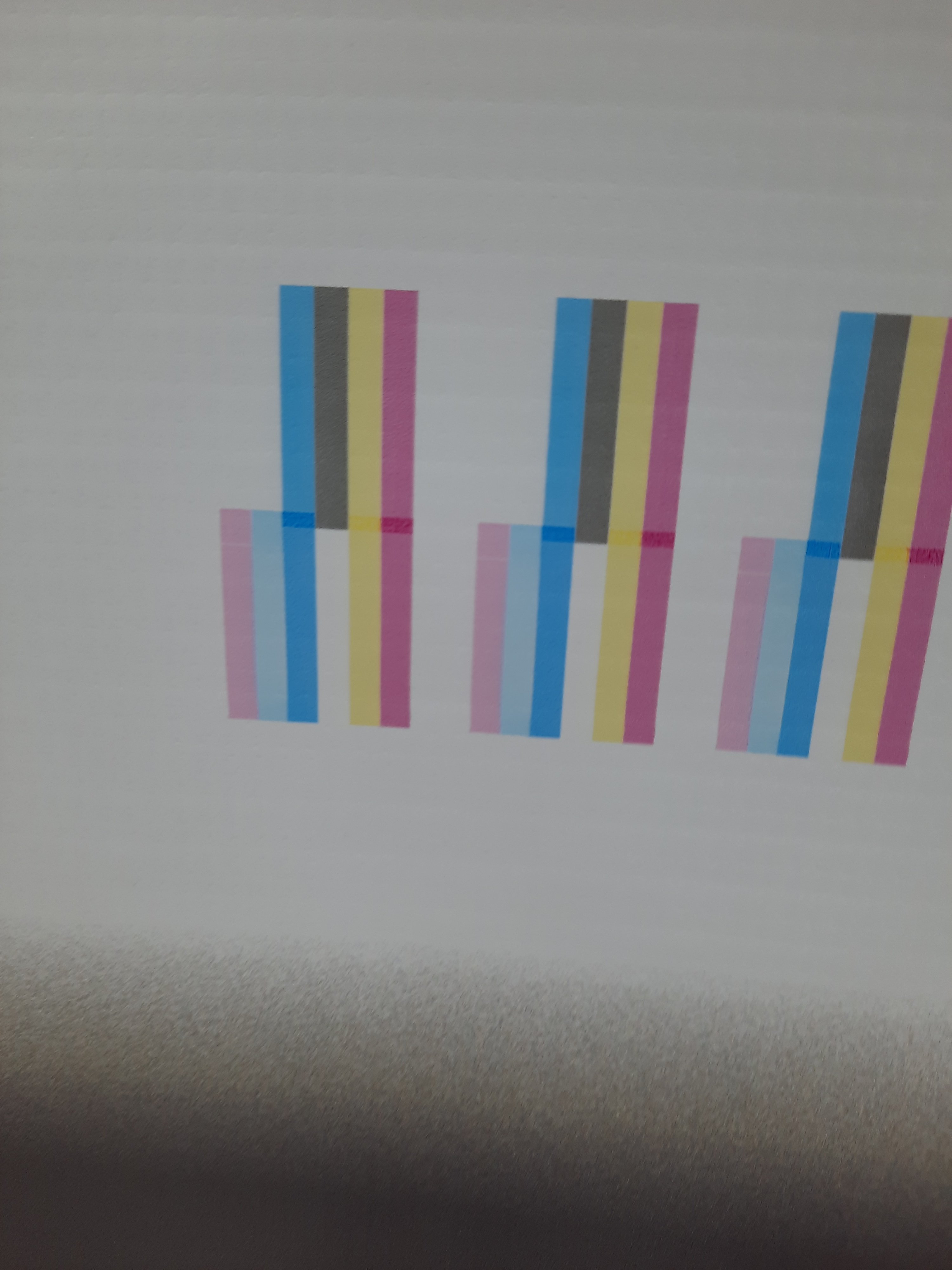

Okay thanks! Changing the black/cyan print head didn't make a difference, I'm going to try one of the light cyan/light magenta heads now. I printed the color bar and it looks fine but is still printing the horizontal lines and verical line

Spit bar has no difference on that spot where the lighter part is?
Just out of curiosity, can you take a picture of it?
balstestrat
Problem Solver
It has to be from the display side (right side).
And from this spot specifically where you can see the white stripe.

As you can clearly see in your third picture one Black is not printing at all. Replace that printhead.
