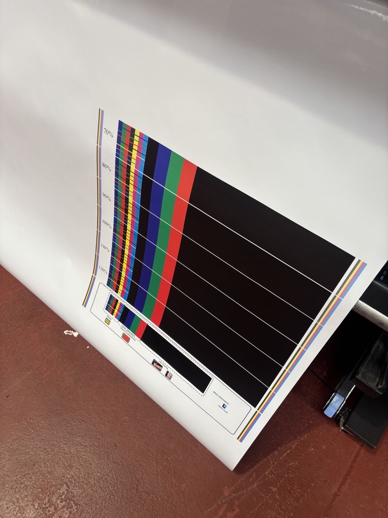

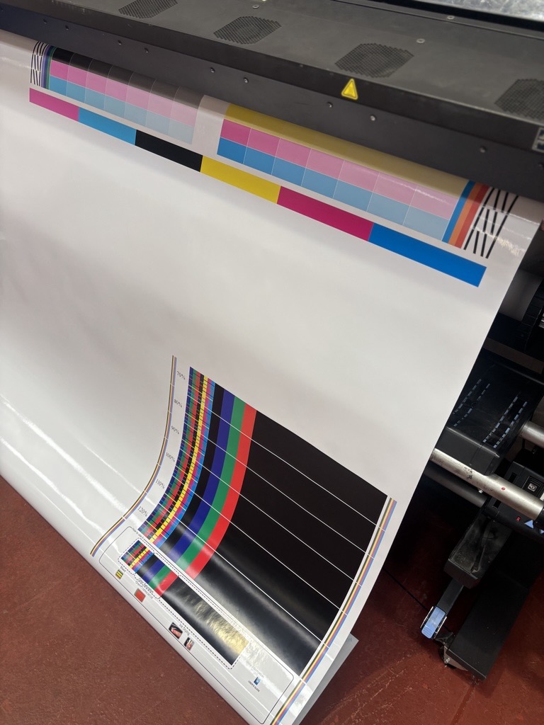

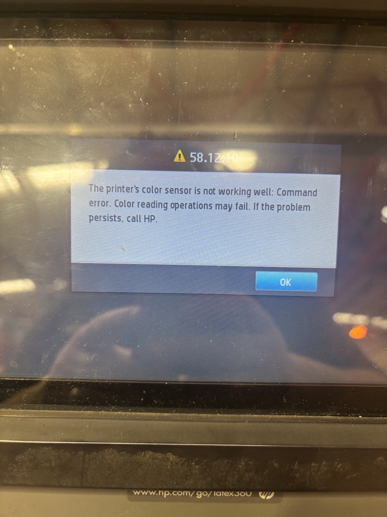

Has anyone else had this problem when trying to modify a profile on the Latex 360?

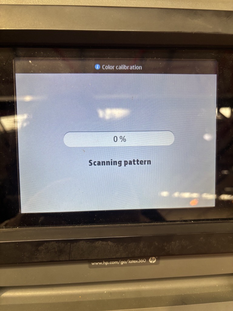

I print out the print test, then the colour calibration pattern no problem and then when the printer goes to scan the pattern it scans a blank part of the vinyl as it doesnt wind the vinyl back through far enough before it starts scanning causing the error messages!
Is there anything I can try or do to sort this problem?

That's pretty important. Means you have issue with the sensor. Check it and the cable, replace if you can't find anything.
