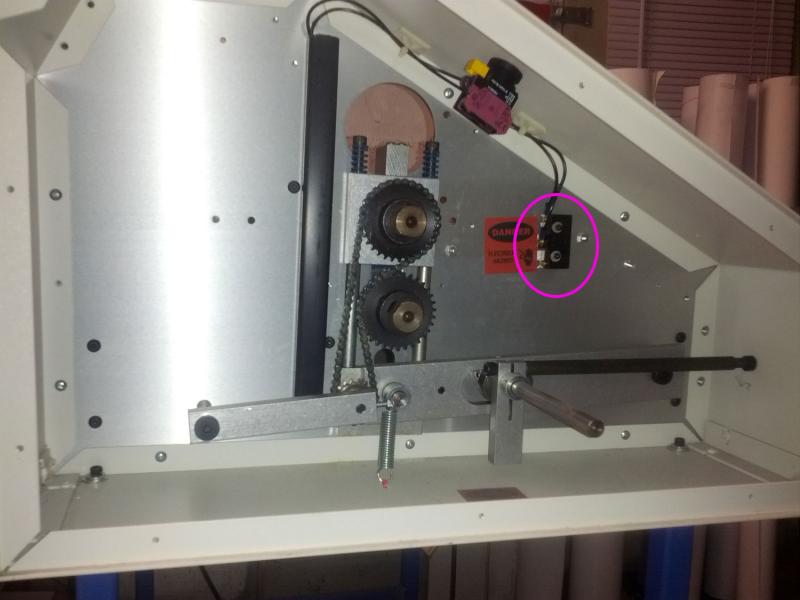

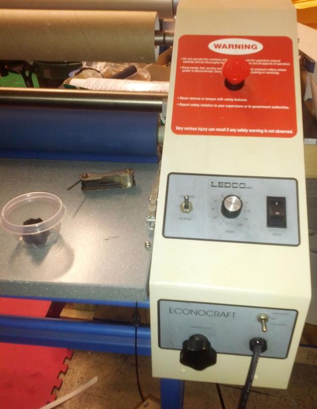

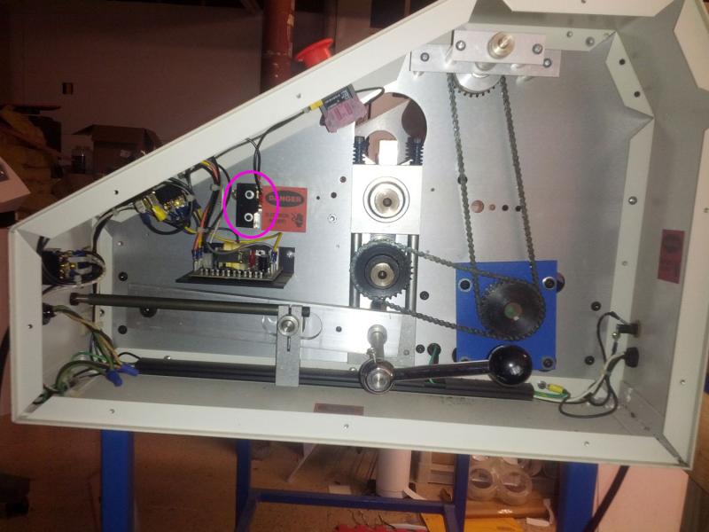

Our 30" Ledco Econocraft laminator just stopped working. The machine was left in drive mode overnight with the emergency button pressed in. The next day, a employee was starting to use it and they usually use the foot pedal switch instead. They were using it for a few inches and then the rollers started to jerk as if the lam was caught. I pressed in the emergency switch to stop it and it did and then we started it again and it went for a few more inches and stopped again for good. Im not sure what exactly caused our problem, the machine in drive and foot pedal use simultaneously??? I replaced the fuse, i wasnt sure if it blew or not but changed it anyway. I opened up the side panels and i bypassed the tray relays and also the emergency button relays. So i ruled out those relays as a possible problem. The machine currently does nothing, i cant get a response from anything. I was checking around inside for any lose connections and couldnt find anything. I noticed there is a small red led on the main computer board which is not lit, is that supposed to be lit? Any suggestions?

From my experience, any time it quits running, it has always been an interlock.
I would check them again.
