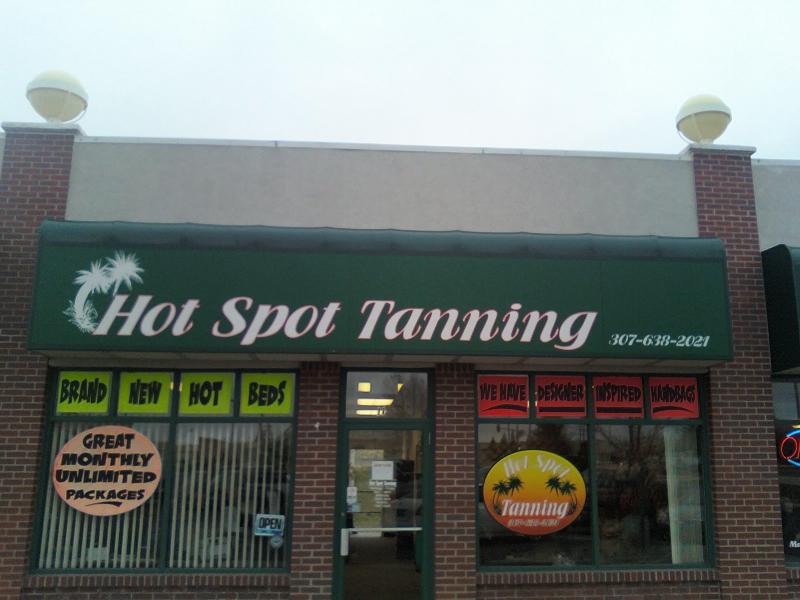

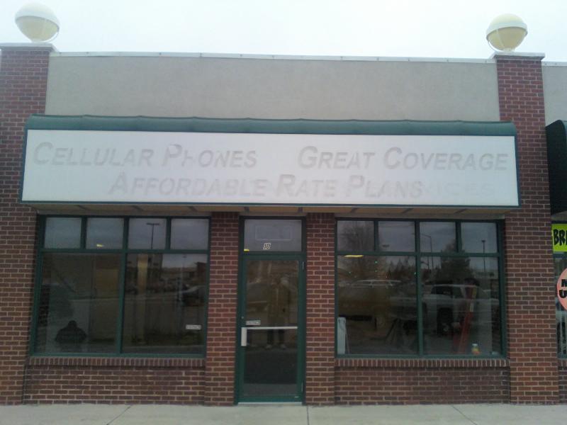

I have been asked to quote putting new lettering on this awning. Judging from other awning in the complex, it looks like originally this large white area 40"h x 20' w was eradicated and then a large piece of vinyl was applied over the area with the new lettering cut out of it. I assume I need to clean off the old adhesive that has collected dirt and then apply new vinyl, correct? How would you do this?

is the front face an insert? if so,, remove it and change the fabric. At the same time they add in the lettering.
artsnletters
is it back lit? if so you're screwed then.

If its backlit we used to just wash the white face off with glue remover,prep, and apply translucent vinyl at the sign dept of the awning company where I worked. as long as the area is white I would suggest a dark green base close to the colr of the rest of the awning and add a bit of color to the copy that catches the eye. It shouldn't be any problem as long as the area is clean and the lights behind it work.
edited to add,..in the past I have taken eradication fluid and washed a red backlit awning off well enough to use a darker color opaque vinyl ink to reverse out a new sign,say like an opaque dark green,...the trick is to get the original white area clean enough for the lighting behind it to work well.it was alot of work but they preferred my days wage to replacing the awning.

is it back lit? if so you're screwed then. Yes it is back lit
Can I clean it, prep it and apply new vinyl with the awning in place? I don't think I have the expertise or space to remove it, work on it and re-install it. If I use an opaque dark green vinyl background, cut out the letters and cut another set of letters in a transluscent vinyl and apply them on the inside of the cut out so there is a white border around the letters and a colored letter will that work? Attached layout idea.

That was exactly what I was talking about,... no reason you shouldn't be able to cover the courtesy panel on front there like in your art,..it should work great as long as the greens match at night,..,
