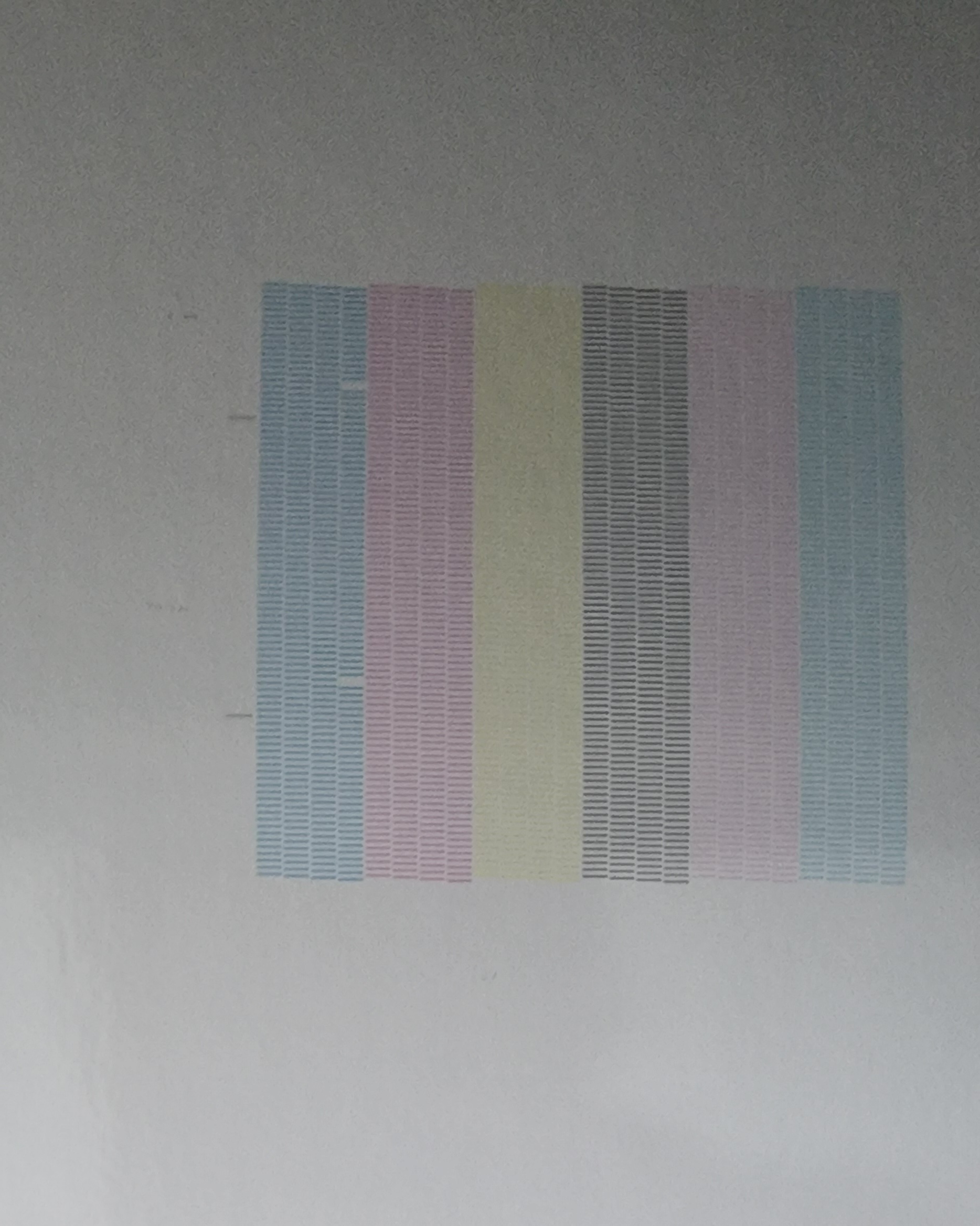

Roland vs 300i, somehow light gray got completely clogged . Is there anything i can do about it ? I already did 3 powerful cleanings and no change .
I haven't dont test print last 2 weeks, my fault I know. I'm printing couple of decals other every day, about 2-3 hours of work . Printer is always plugged in . How did I get this bad .
In previous years I even went on vocations 3-4 weeks . Left printer pluged in, and it never been this bad.
Please help.
James Gallant
Graphic Designer
You could try a 48 hour head cleaning. Another thing to make sure is that the Cap top isn't too old, might need to replace it.
James Gallant
Graphic Designer
I'd recommend changing it every 6 months. If it's that old, it would be worth changing, but you can do the 48 hour head soak first, and then change it, that way it will have a fresh cap top.
Printer101
I did head soak and changed the cap top. Thanks everyone. It helped and the the head got unclogged.
