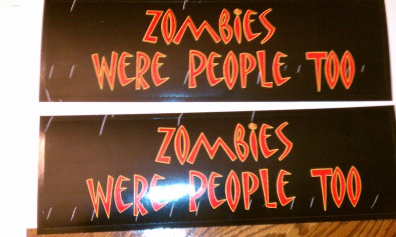

I am getting white lines in my black fill !
The other stickers and letters are fine.
jayhawksigns
You are getting creases in the ribbon, I think.
Had this happen before, try swapping the tray the ribbon is in, be sure to swap the chip too. See if it goes away and let us know.

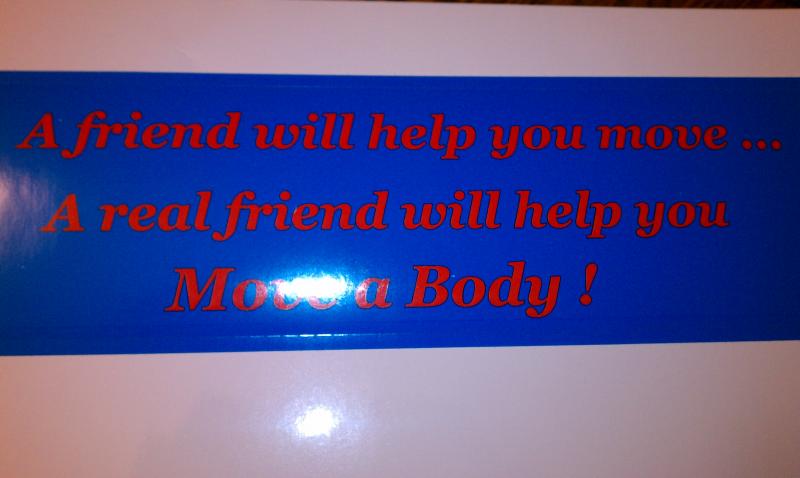

I put a new ribbon with a new tray.
No change,except now there are lines in the blue.
What next ?
garisimo
You need to turn down the density setting -- most times, even if your density is too high, prints come out fine b/c you aren't printing solid blocks of color. With a density too high and solid blocks the ribbon has a tendency to bunch or wrinkle, resulting in these lines.

Thank you.
I claned the head and ran a line feed calibration,all looked good.
Tried running the stickers again, same thing.
I made a black box for a test print, it broke the ribbon !
I will adjust the density .
Thanks for the help.
