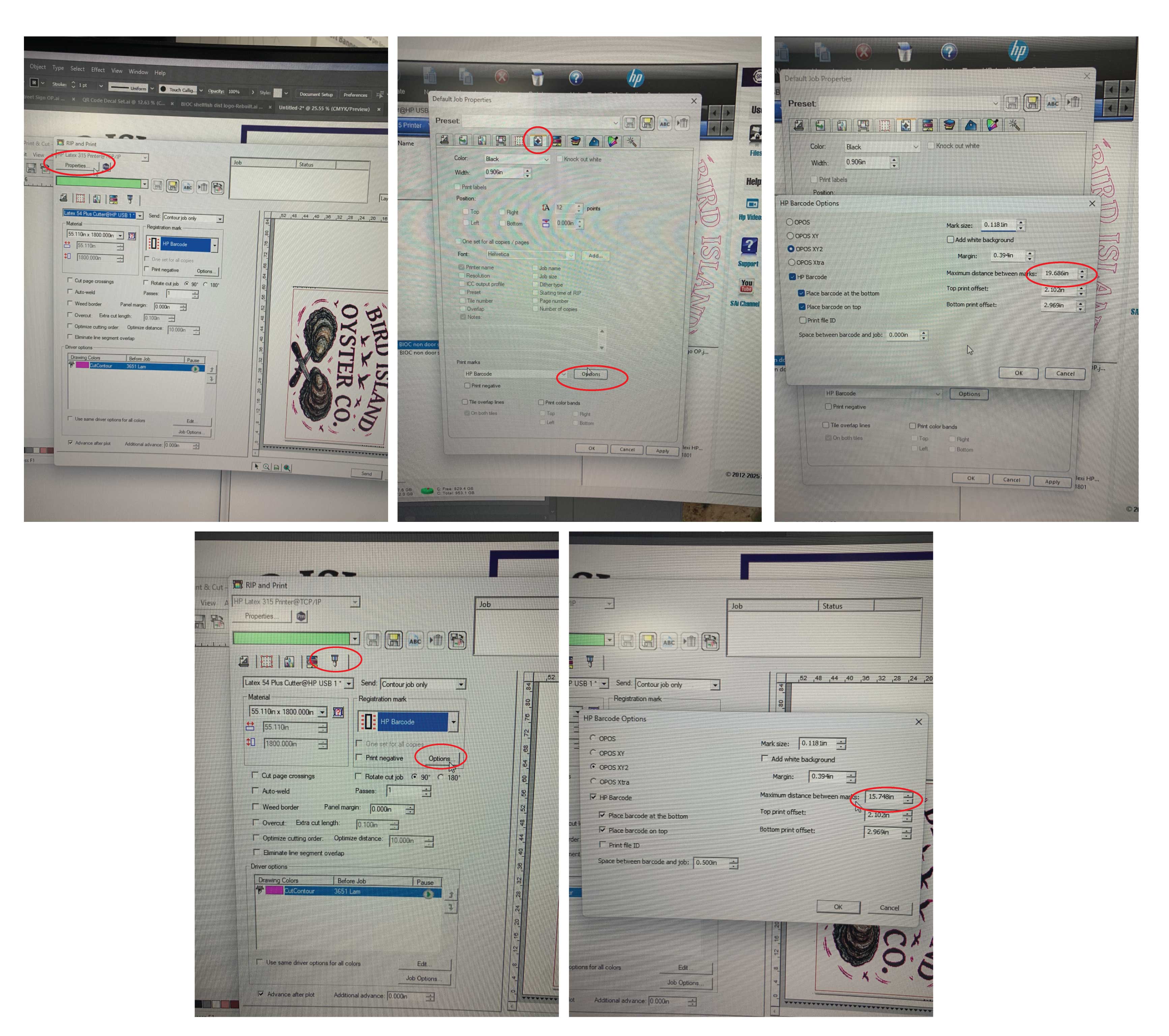

I've stumbled across the issue on this, at least for our machine. I don't know why it's using two separate measurements in Flexi because it seems to be completely random. Most larger jobs do fine, but the occasional random one starts looking a few inches past the mark. Flexi was using two separate MAX distances between marks. I'm attaching pics of our setup for reference, but here's the gist:
In HP Flexi in the "Rip & Print" window, under the cutter tab, in the registration mark area click the "options" button. Copy, or make note of the number in the "Maximum distance between marks" field.
Then, in the "Rip & Print" window, at the top left click the properties button, under the "Registration Marks" tab, click the options button. Paste or type the same number from the previous step.
Close that out, then in the "Send:" drop down menu, set it to "Contour Jobs Only" then click send and follow prompts to move the tool over the mark. It should start cutting in the correct place from there.
