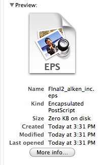

Got the email. Unfortunately I won't be able to help.
These files are Zero KB in size. I would assume your customer incorrectly saved the files. Ask them to re-save the files and you should be good to go.
An eps on a Mac is the same as an EPS file on a PC so that was not the issue.

Make sure your client emails you .sit or .zip of eps files cause they get corrupt in email. Or they can save as a .pdf, which can then be opened in Illy.
