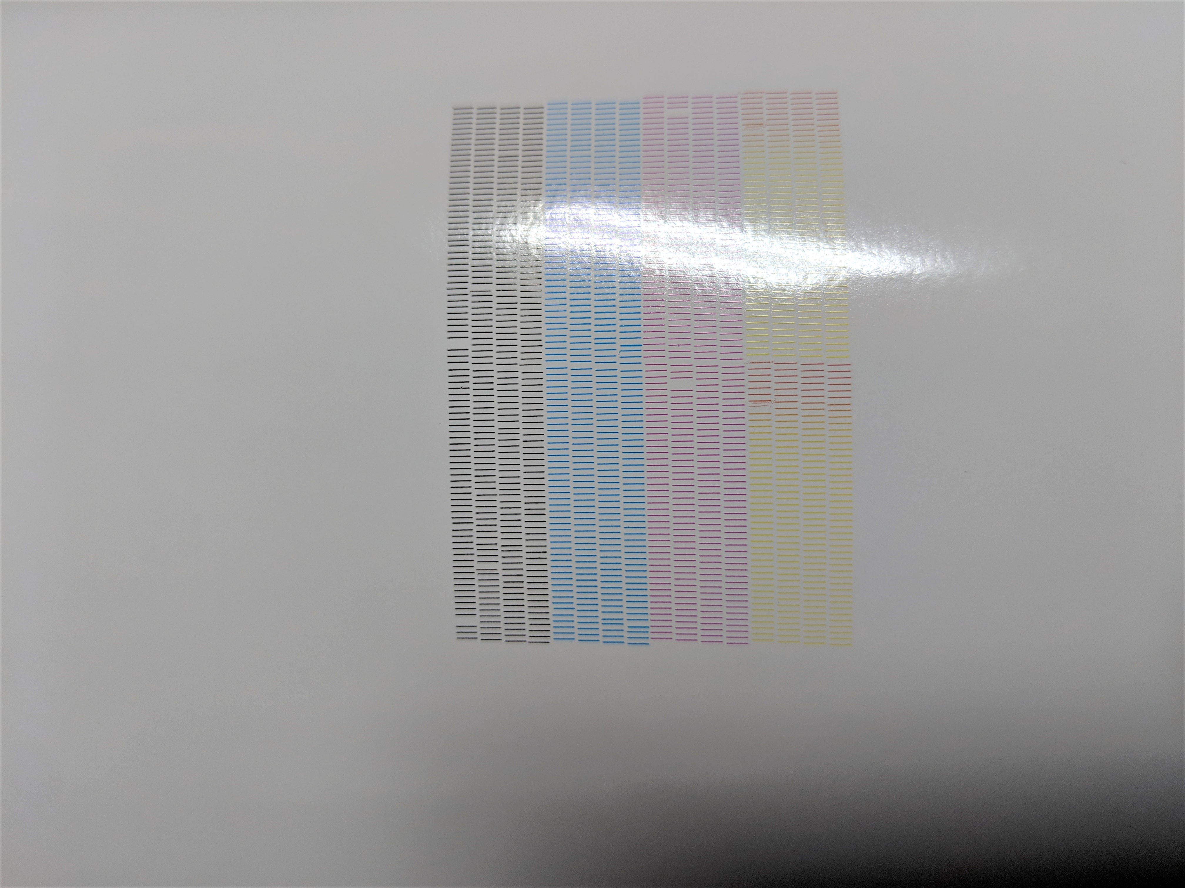

So this morning I noticed the I'm getting magenta in my yellow printing. Bad head or something else? Can't afford to be down at all right now. I'm running a SP-540V

Broome Signs
Hi its normally down to ink levels
Especially if you are using a bulk ink system or 3rd party inks as they may be more diluted than originals
Do the yellow and magenta shear the same pump?
If so yellow ink is lower than magenta and the magenta is being pulled into the head via the pump station
A few powerful cleans will normally rectify the problem before printing
If the yellow damper has been contaminated you will need to swap it out
Quick fix remove damper from head and use a syringe to pull the contaminated ink out
allways try to keep even preshour across the ink levels

I'm still learning about the machine and more now that I'm having to figure out how to do the maintenance myself on it. I believe they do share the same pump. My yellow ink level was lower so that was probably it. I'll run another test when I get a moment. Thank you!

There is only one pump on this machine so they all share one. The yellow and magenta share a cap top.
Cross contamination can be caused by a few things. The most common is failing maintenance parts such as cap tops and pump. If the cap top and/or pump tubes are partially clogged they will fail to drain properly which causes the head to dock while ink is still in the cap top which then gets sucked up into the head. Also, if the wiper is super dirty it will contaminate the head as well.
Dampers can also cause this. If one damper is failing and the other is working fine, it is common for the working one to become contaminated due to ink dropping out of the head while docked and it shouldn't.
If an ink cartridge is empty and not flagging the machine properly it will cause this issue as well.
And last but not least you have the dreaded punctured membrane. As with anything these parts do wear down over time. If you have new cap tops, dampers, the pump is working properly, you know fore sure your ink cartridges are not defective, and you still can't get rid of the magenta in the yellow, the internal membrane that separates the channels has punctured and will not be fixable. In that case you just have to spring for a new head.
