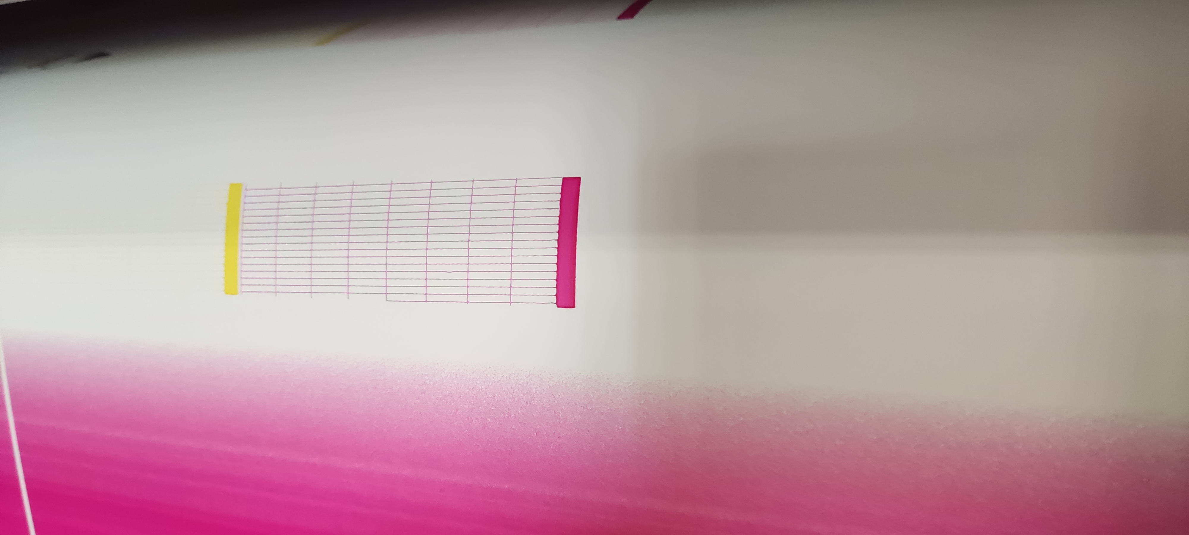

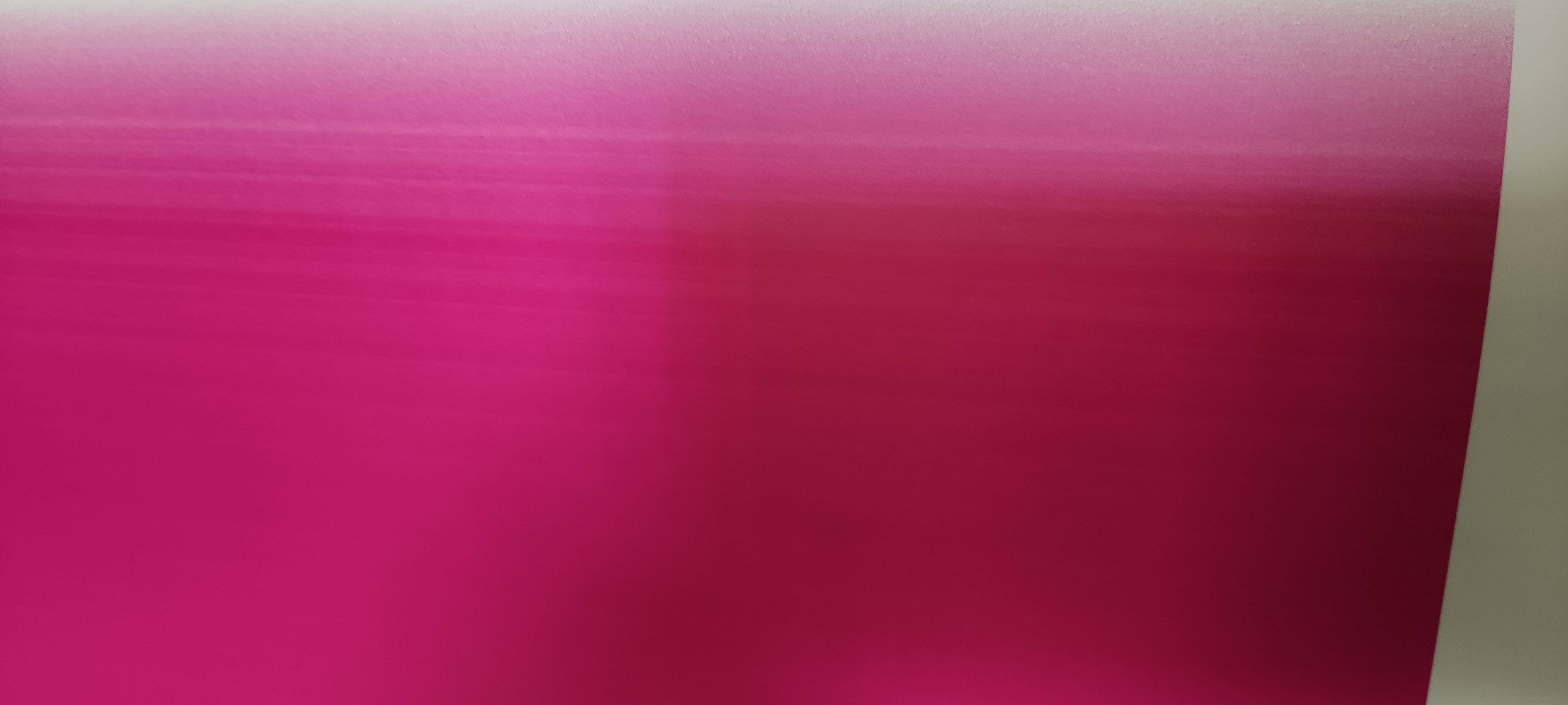

Friday morning runout of magenta, change cart, print another half magenta cart and on friday evening I notticed banding and loss of color in Magenta. Replace printhead no 6 and go home.

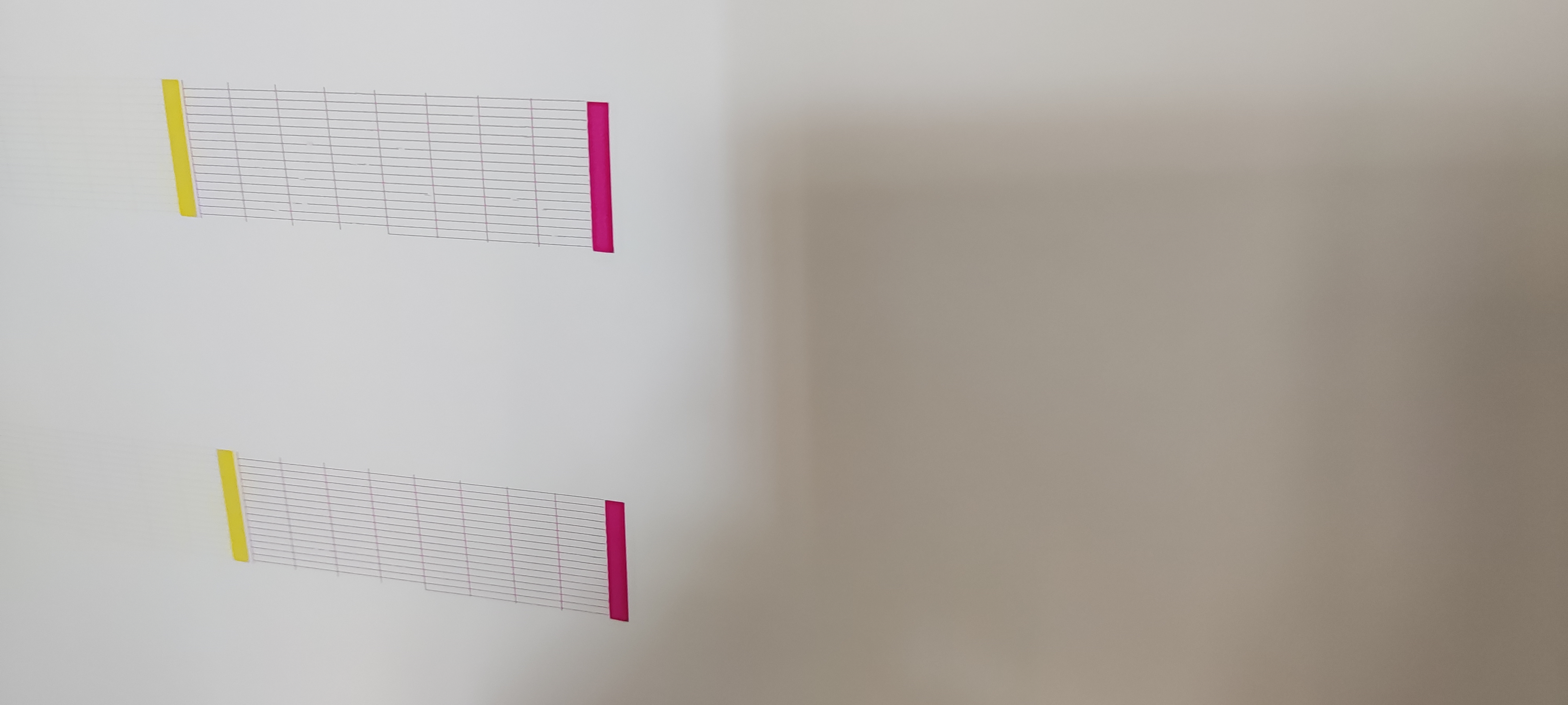

Saturday morning, after only 2 sq meters magenta banding reapears, a nozzle check: the same printhead.
Long story short: the no 6 channel, magenta ink starves only after less than sqm after a printhead cleaning. The no 5 megenta printhead is (in almost all the cases the same as ever). As I say, a normal cleaning results in (almost) perfect nozzle check.
What I did: clean the droplet sensor, clen the printhead electrical contacts, shake the magenta ink cart, turn of and back on the printer. No effect.
The serviceman suggests a bad ink cart, but I doubt it since only one magenta channel gets clogged/starving.
Any other thouts?
