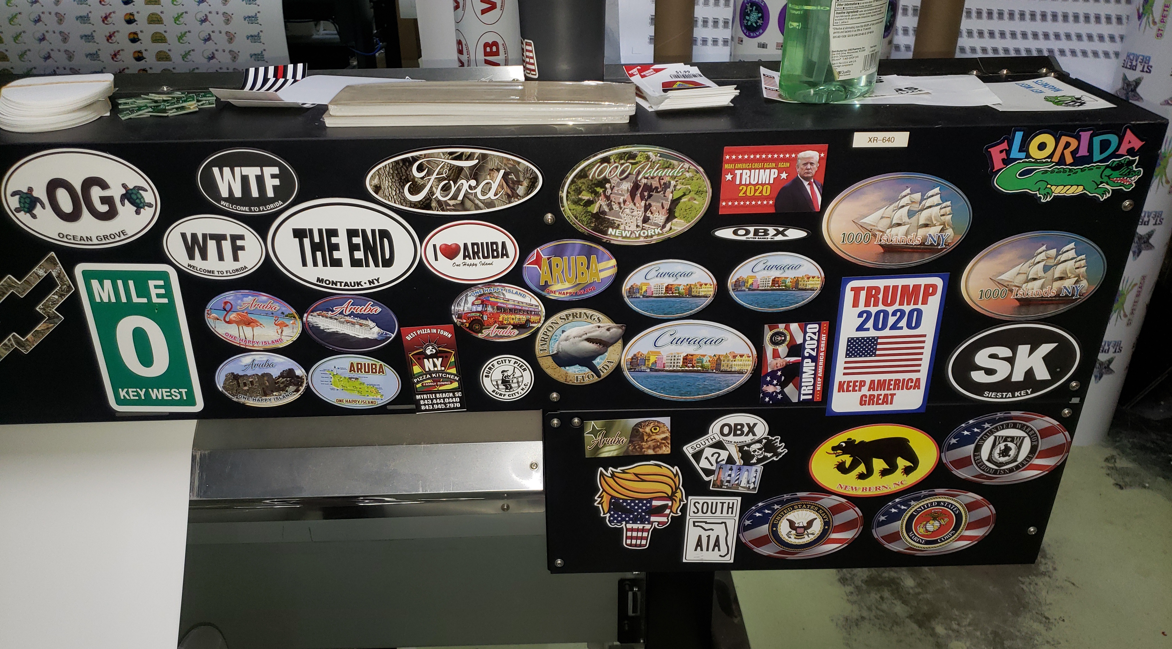

I printed 60 rolls of 30"×50' Magnum last year on Roland XR-640, Huge Profit $450 - $600 per roll.
