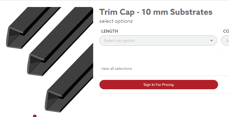

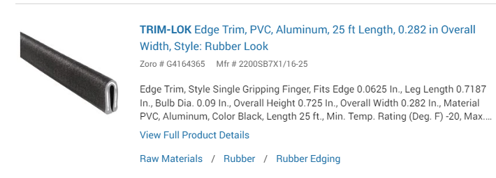

I do the same thing that Accent Sign does...trim 1/8" all around. There's also edge trim you can buy, I've done that a couple times and you adhere it with some adhesive. I used something like this on rectangluar signs and I used some rubber stuff for an oval sign. I avoid it but sometimes certain signs just need a finishing touch.

We only use edge trim cap on MDO or fluted ACM
