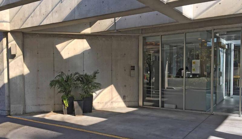

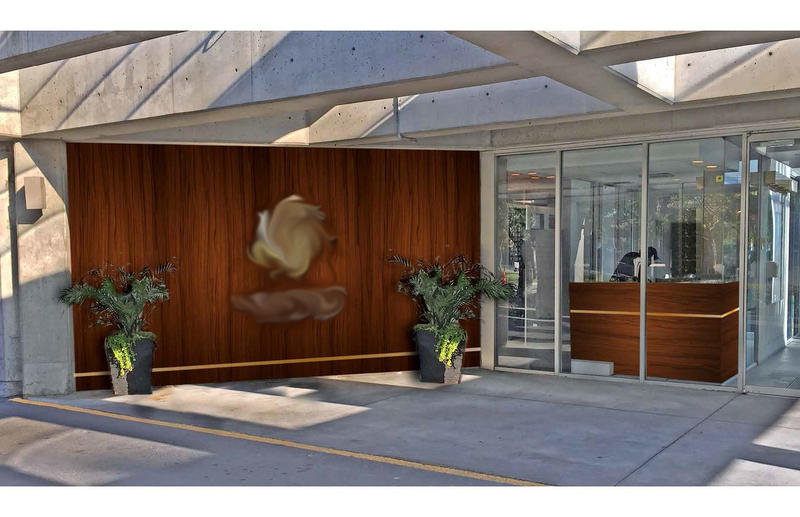

So I've got this new project I'm working on. The designer want an exterior wall made of concrete look like wood. For the interior front desk, it's not a problem, I can use dinoc. But what about the exterior? The customer would like to use the same wood on few parts in the interior as well. This wall is not directly exposed to the elements, but remember I'm in Canada with REAL winter.
So I need a solution that would work for this exterior wall AND the interior element as well.
What do you suggest?

What about some ACM sheets covered with the dinoc and fixed some way on the wall? The wall is 110in high and 16ft long. So it would be 4 panels side by side. I'm also open to other suggestions.

Edited to add, I like your conceptual, what is the thing in the middle? Is that their logo you blurred out or
actually part of the art...
