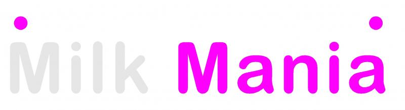

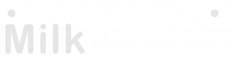

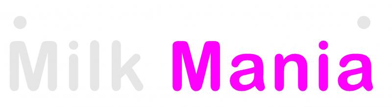

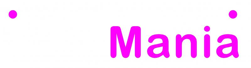

Have registration marks in the top corners, exact same dot one color on top of the other (being the two colors you're cutting).
Then just light the two registration marks up and your vinyl will be exactly how it was on the computer.
Examples...

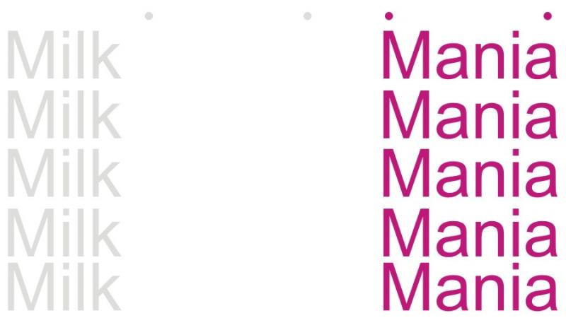

+1 like so...

qmr55
I agree with both of your posts
I have a printer and I still do most of these the way you described.
unless each of the 50 is a totally different color.
you can lay up 50 of these in no time and they will last longer.
you can even array a bunch of them up and down and use registration marks for each bunch.
Exactly my thoughts! Since 10 are to be the same second color, do those ten at a time and it will be quick and easy!
Optic
Now you're rockin' with that registration.
