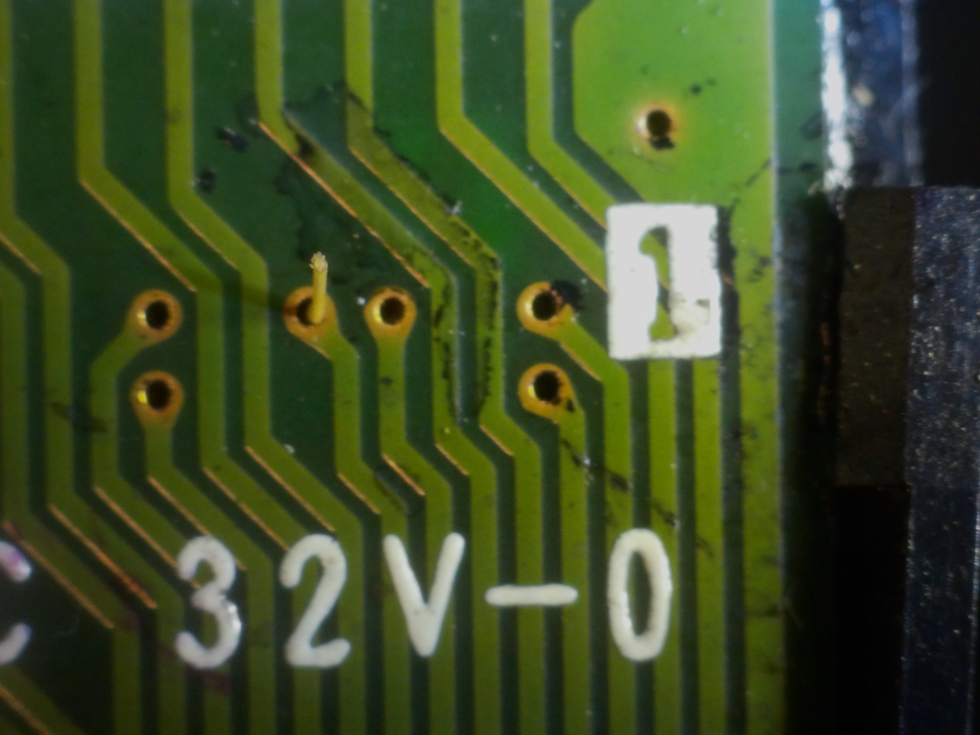

Last week my CJV150 went down 2 months out of warranty with an error saying
Error System Halt (2) 1b4:pCB SLDR2H-F2 after replacing F2 fuse it gave Error 187 HDC Slew Rate, then immediately blew the fuse. After speaking to tech support it was determined that the slider board needed to be replaced. I ordered one and hired my tech to install it. Mimaki has a flat rate charge of $1440 for labor and $1614 for travel! Long story short it wasn't the slider board it was something going on with the head. Below is what the tech determined with photos included. Should I pursue this or go ahead and buy a new head. Advice appreciated.
From tech:
It appears that this head should have never passed inspection!
There was an uncompleted attempt to repair an open via on the PCB. The wire was placed, and bent, but never soldered! 2018_0112_011422_002.JPG
Joe House
Sign Equipment Technician
You can ask, but they have no obligation after the warranty period has ended. The recommendation doesn't come with a guarantee as they aren't onsite to inspect anything and are basing their recommendation on what you tell them. Depending on the relationship your tech has with Mimaki, you might be able to get some kind of consideration.
Smoke_Jaguar
