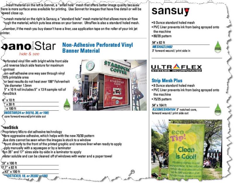

What kind of "mesh" are you after? Here are some on the Fellers site.
Noumenon
That flexmesh stuff looks about right. I'm basically wanting to do banners that when viewed up close you can see has little holes in it, and from afar is somewhat translucent. I'm guessing made from vinyl but not really sure. I saw some vertical banners like this at an outdoor concert and thought they looked really nice. Thanks a bunch for the link.

Listed in the link above, the Ultraflex Strip Mesh with liner works well with ECO-SOL MAX and the SOLJET PRO III models, you may want to use the MCVP profile in Roland VersaWorks as a starting point for printing.
Feel free to PM or call our Technical Support Department at 1-800-542-2307 and Press "2".
