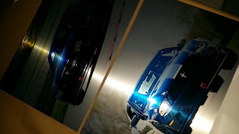

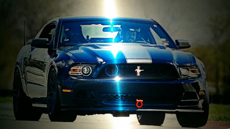

We make them all the time for our resellers. Just finished a set of 16 x 24's.
It really is difficult to capture how these actually look. We use the bare metal background with the shiny finish and is the Chromaluxe brand, though.
