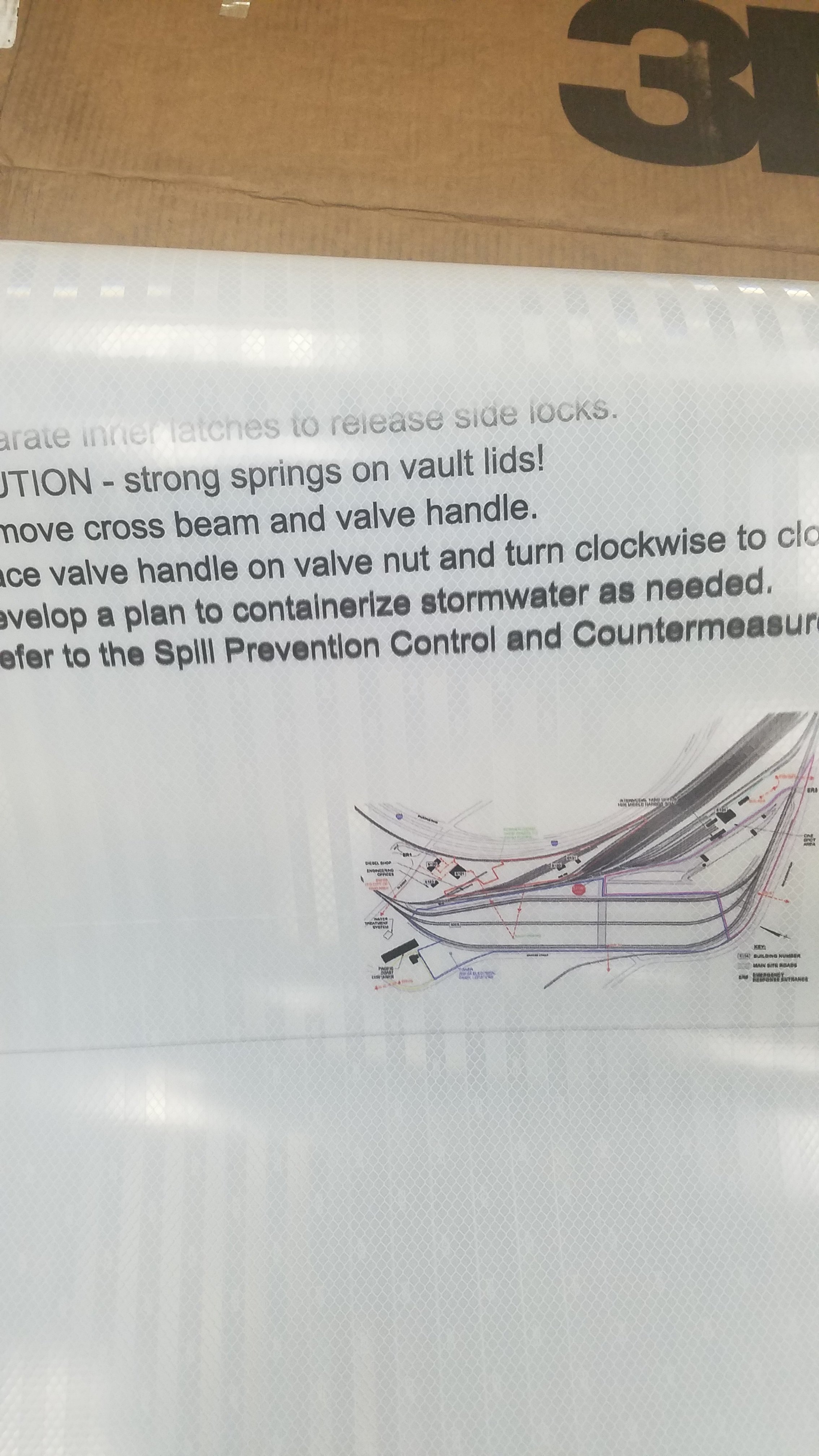

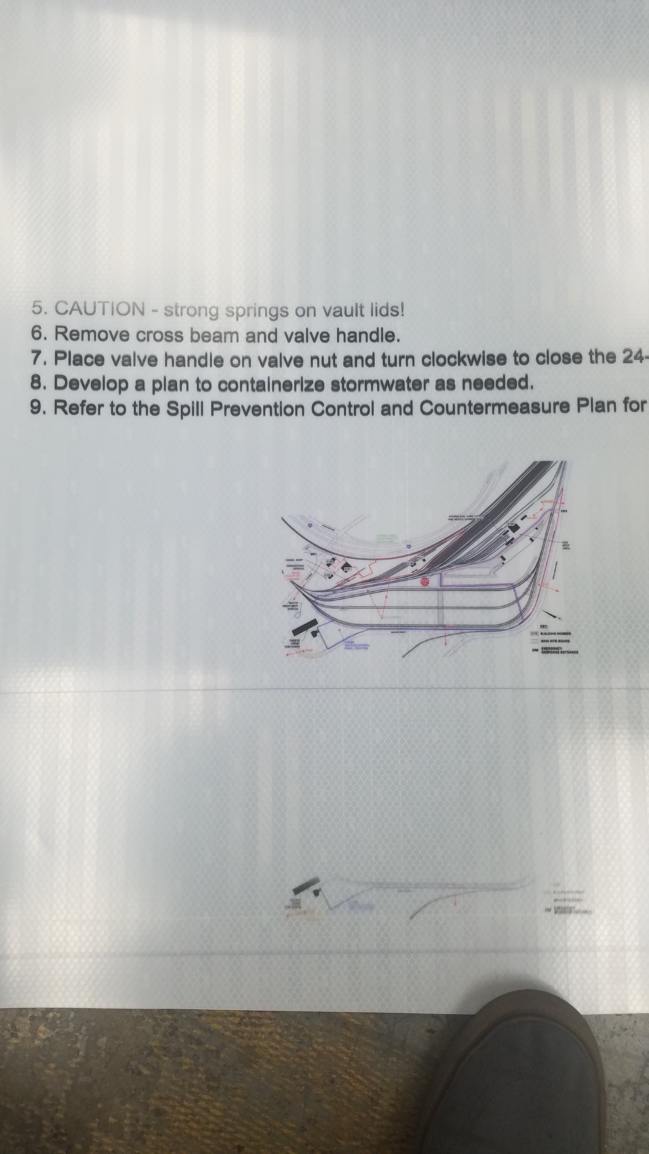

We have a latex L360 print on reflective all the time.  We are having some new random issues.  Wondering if anyone else has had similar issues and if you found a fix.  Right now the problems are happening with EGP and HIP reflective 3M brand.  We are printing using 3Ms profiles for the media.  When We print a NO Parking sign we get these areas where the vertical alignment seems to go out of wack and the text gets fuzzy.  Sometimes its for .5" and other times it goes for 2-3".  It will happen and then correct itself and go for another foot or two and then do it again.  It's also drastically changing the vertical length of these prints.  12x18 are coming out 12x17.5" or worse.  The lines that run vertical on the print or super clear so I don't think it's encoder strip.  It's almost like sometimes it does .25" between passes and then other times decides it only wants to move .1" between passes and other times decides it wants to move further then it's supposed to. Attached are pictures.  You can see the map  starts printing clean and then becomes worse and then starts to get better as the next lines of text come up.  What makes me think it's the OMAS and the reflective is that as soon as we switch to white vinyl the issue will go away.  Go back to the reflective and the issues are back even if you print with the white vinyl profile.
