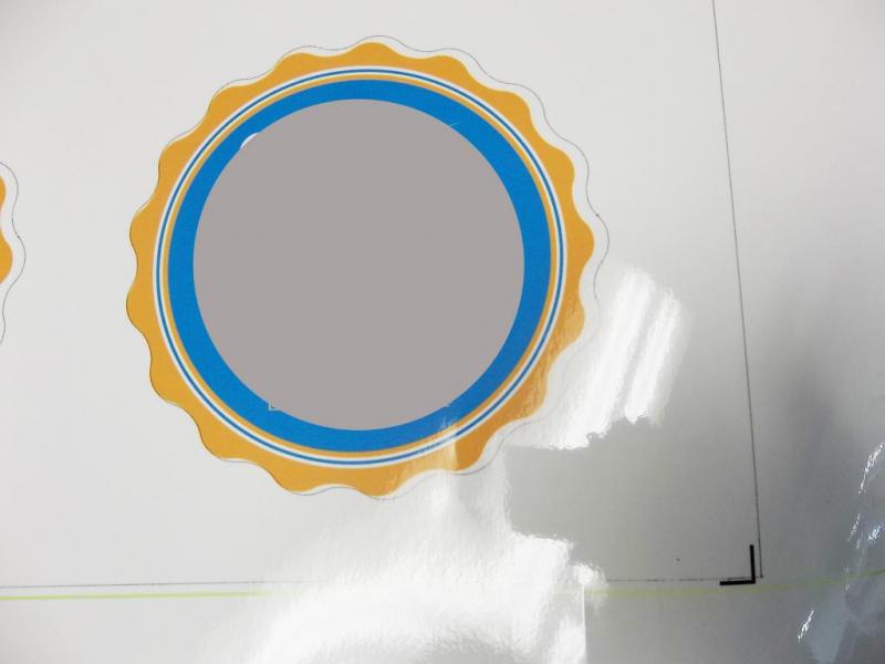

Trying to contour cut using FineCut8 with Ai CS4 (can't get it to work on Ai CC, which is another problem unto itself). No matter what I do, I cannot get the contour cutting to stay lined up properly and cut along where it's supposed to for the entire process. The first few cuts are pretty close, and are always the ones closest to the right side of the machine.
As it travels outward, the cut is more and more off. I have tried using/making all kinds of guidelines to line up everything properly when I load the material, but nothing seems to be working. (And yes, I use the Register Marks and the laser eye to line things up, as well.)

Still dealing with this problem. After register mark stuff is done, the contour cuts start out on target, then drift up to a 1/2" off.

ALWAYS the same outcome. Cuts are off the outline.

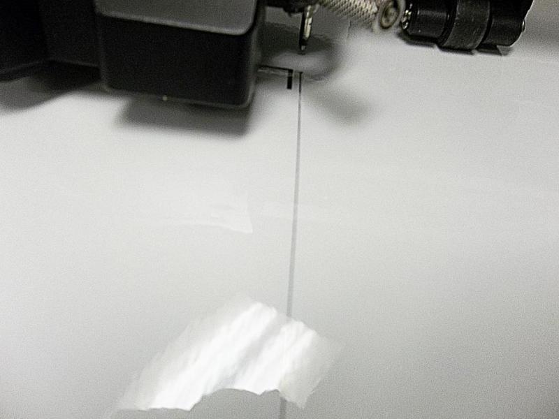

Added problem is that the cuts are "picking" leaving scraggly spots in the vinyl, also not finishing and not closing off cuts where they should be, resulting in a lot of hand cuts so that I can weed the vinyl properly. (mises closing the letter or shape by about 2 mm sometimes, so I have to use the x-acto to complete the cut so I can finish weeding.))

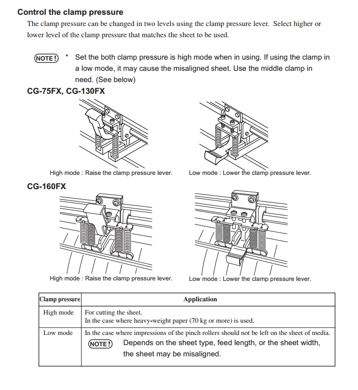

clamp pressure is one. run all high

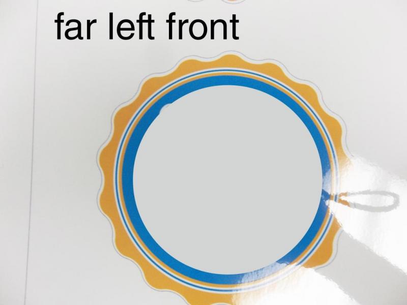

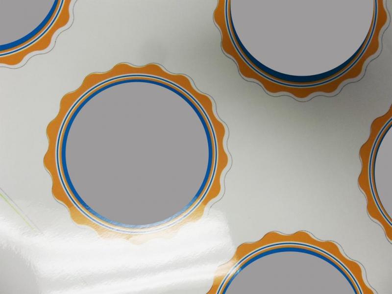

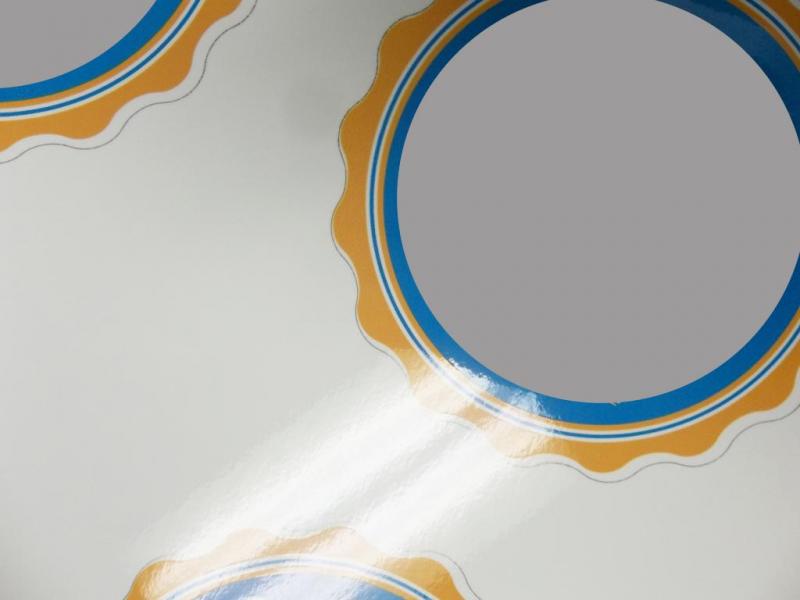

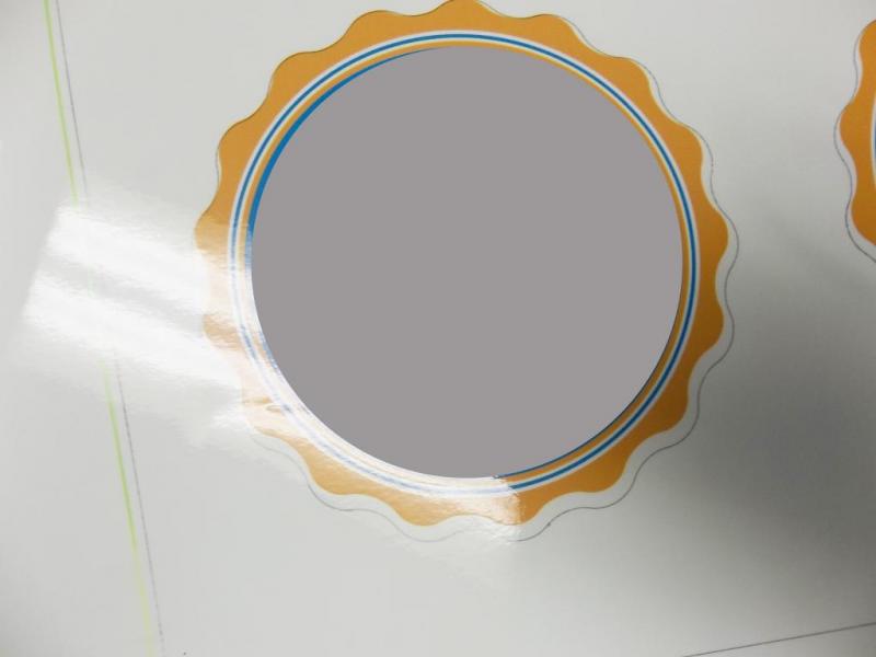

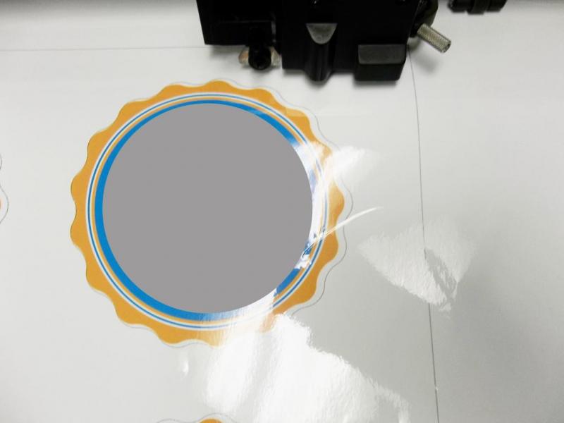

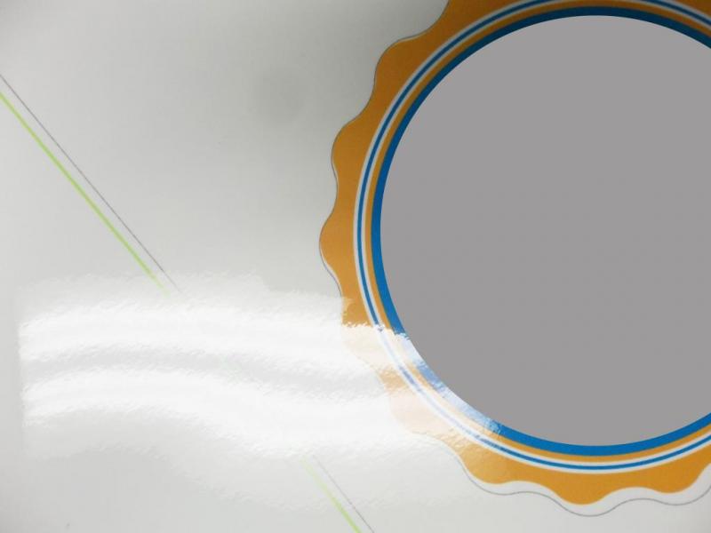

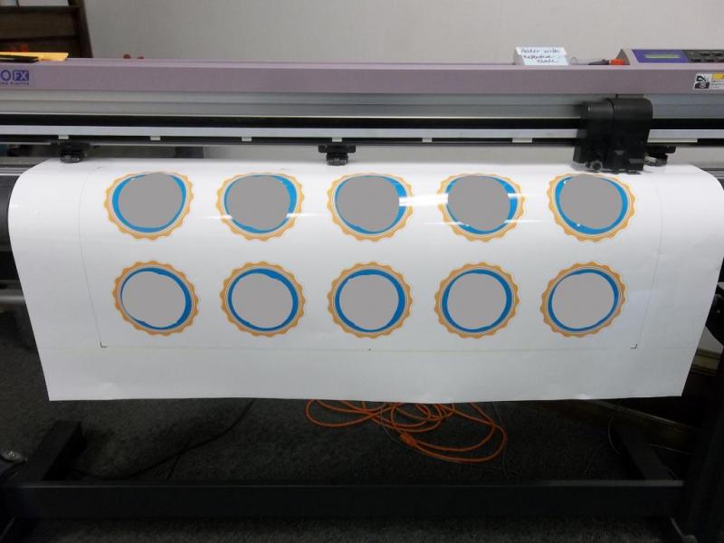

These were done with the pen so it would show exactly where the blade would be cutting. The very front, far left decal cut almost perfectly, but it's the only one.
I can't figure out why these are so off, and the Mimaki manual is pretty much broken English, it's missing images/steps and I can barely follow it. My TP1 gives me an extra step after mark detection now, as well. I have no idea how to fix this. I am NOT mechanically inclined with electronics.
