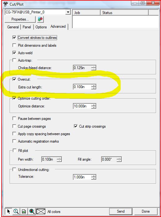

I finally figured something out, although it's not technically over-cut. Its a setting called ADJ-PRS OFS. It adjusts the pressure when it makes turns or at the end of a cut. I turned that up to max (7) and that seemed to help. It's not a true overcut, but it does make it easier to weed. Much easier. I went through the manual with a fine tooth comb, tracked down every menu function, and there just isn't anything for overcut. Guess this machine isn't actually capable of doing it.
You can change it in Flexi if that's what you use.
