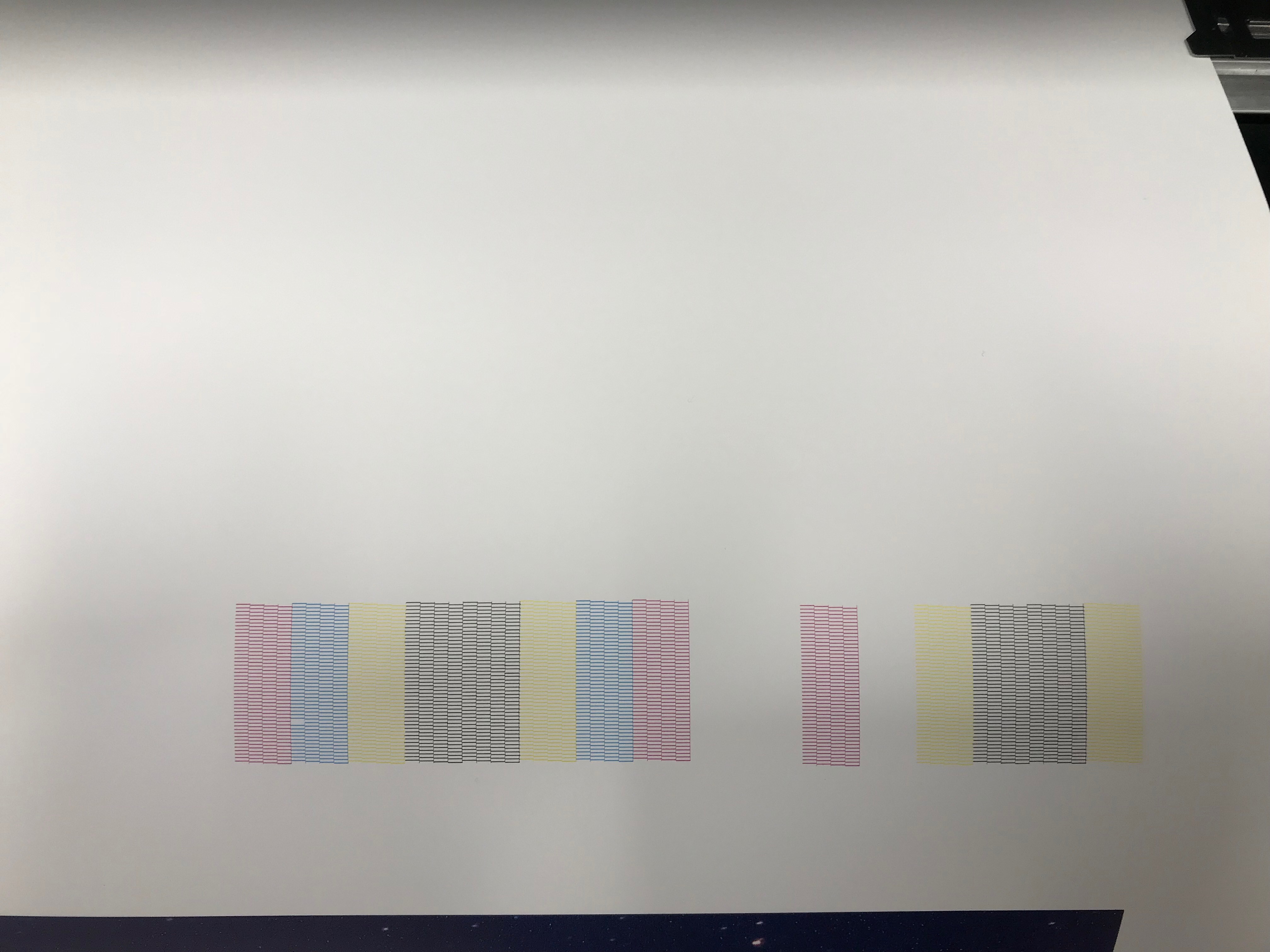

Hello,
I have Mimaki CJV 150 for 3 years. Last two months I have to do clean nozzle every 3 - 4 m2.
Any ideas what could be wrong?
BrA
hand851
Roland Mutoh & Mimaki inks digiprint-parts.com
When was the last time you replaced the dampers, cap top and or pump?
