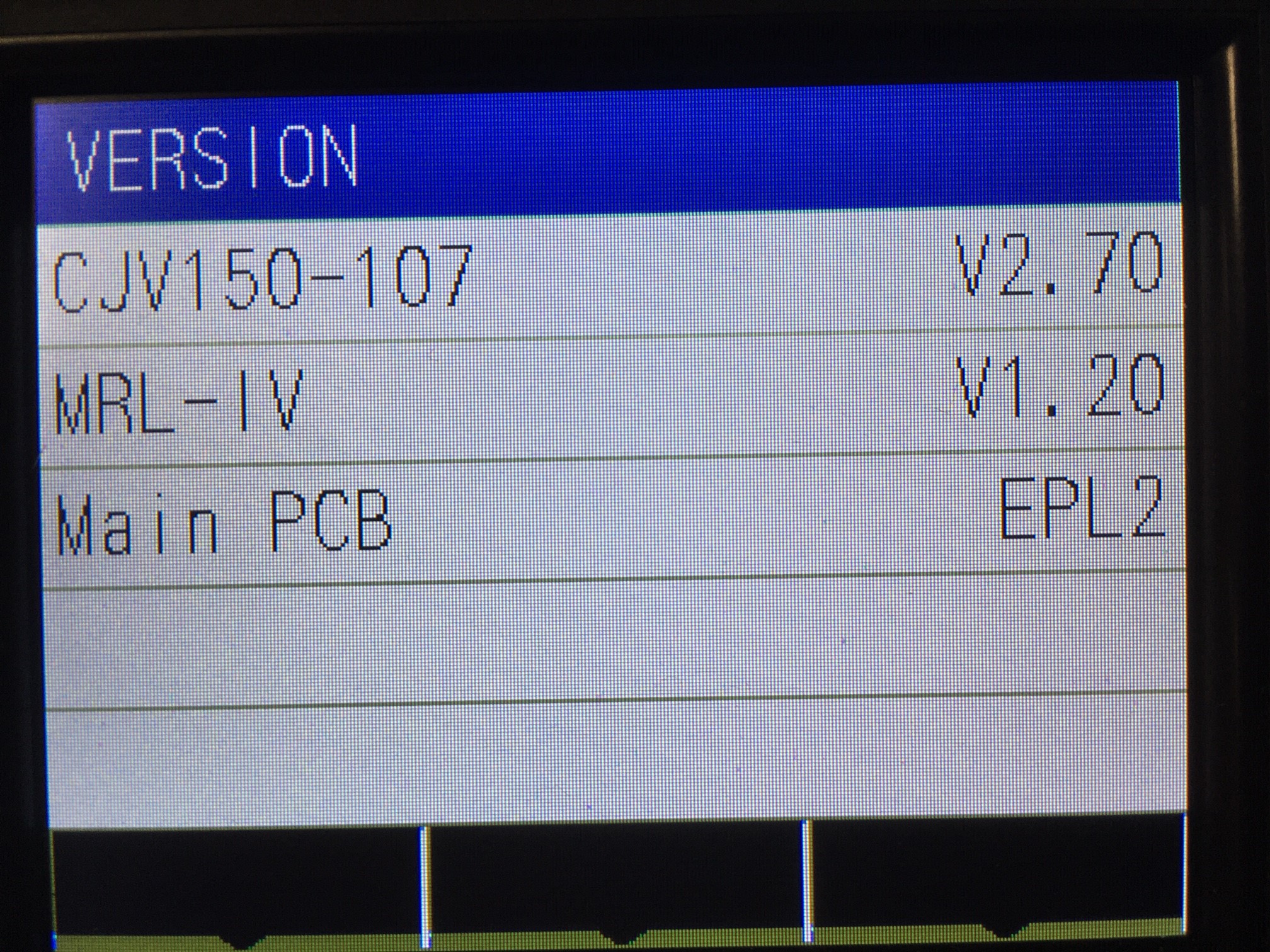

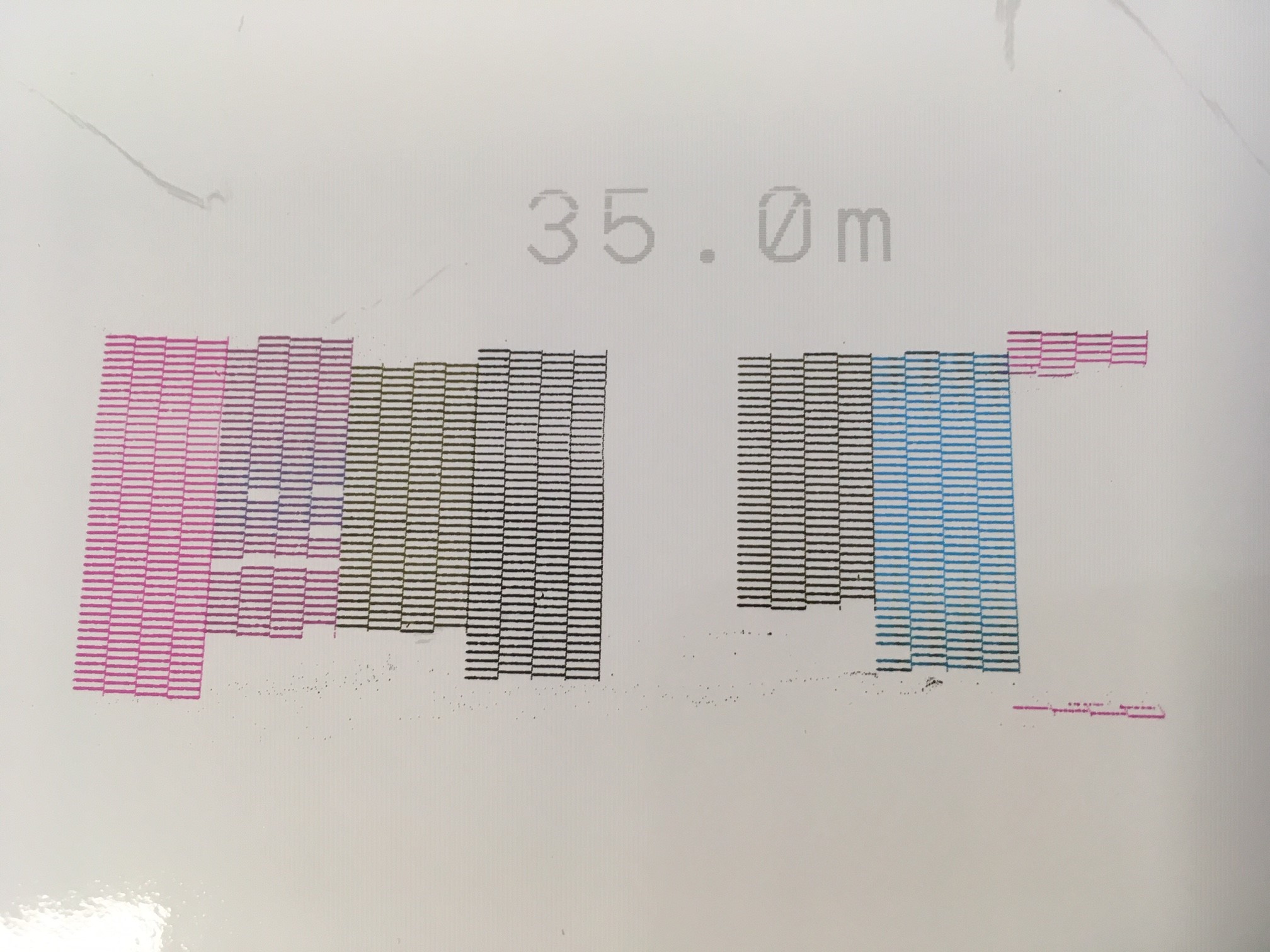

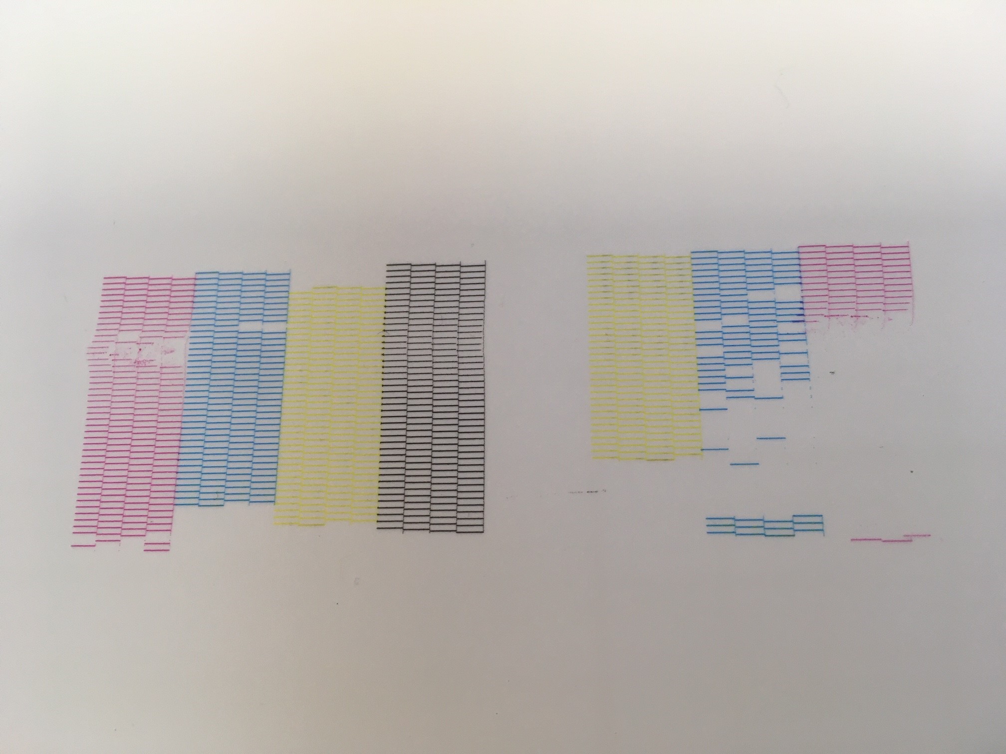

CJV150_01.jpg CJV150_02.jpg CJV150ver.jpg Hi have a problem with a Mimaki cjv150-107.
Service and firmware update ,then went in to storage for a month.
I´v done nozzle cleaning 10 times and upp to 1hour.
needs new dampers or head?

Sitting for a month will do that. Make sure your pump is not clogged by pushing cleaning solution through it with a syringe. Then make sure the bottom of the head is nice and clean. The area where the cap top connects usually will have ink build up that prevents a seal between the cap and head. It sounds like you have already done a few head soaks which is normally what I would do as well. At the end of the day the machine shouldn't sit for so long. The last resort is flushing the head directly with a syringe and cleaning solution. This can break the head internally though.
In my experience, heavy cleaning can show worse test prints than not cleaning at all. Have you tried to print anything? I would do another test print, then print a large full color print on some cheap media and do another test print afterward to see if the nozzles slowly start coming back. Sometimes after sitting, you just need to run some ink through it to open things up again.
