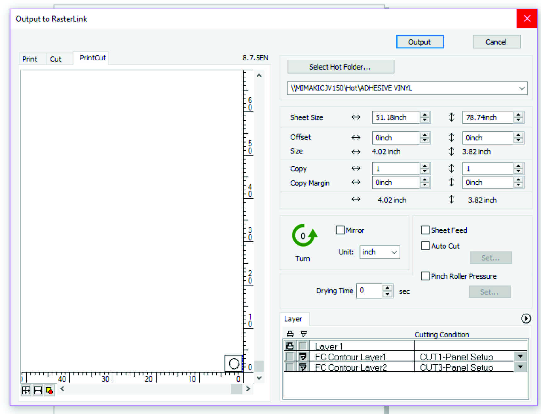

			You also need to specify the cut condition when outputting to your RIP. I have CUT1 set up on the printer for contour cutting the vinyl layer and CUT3 with HALF-CUT turned on and higher cut pressure for the perf cut through the backing layer.

Having each cut condition set for each material we run was originally what I intended to do, and did for some time. But lately, it's gotten to the point where we are now running more material/laminate combinations than we can have programmed into the machine so I just use the first cut condition (CUT1) all the time and change the settings manually before cutting each job.
I keep a sheet to record the cut settings for each job/material I run and it works out better, at least for me. This also allows me to make adjustments when the need arises, fine tune the cut settings that I use for each type of material, and have a record of it. This has been especially useful for fine tuning half cut settings, which can be daunting, to say the least. But now that I've got my settings down through much trial and error, my half cuts look like perfect die cuts every time.
