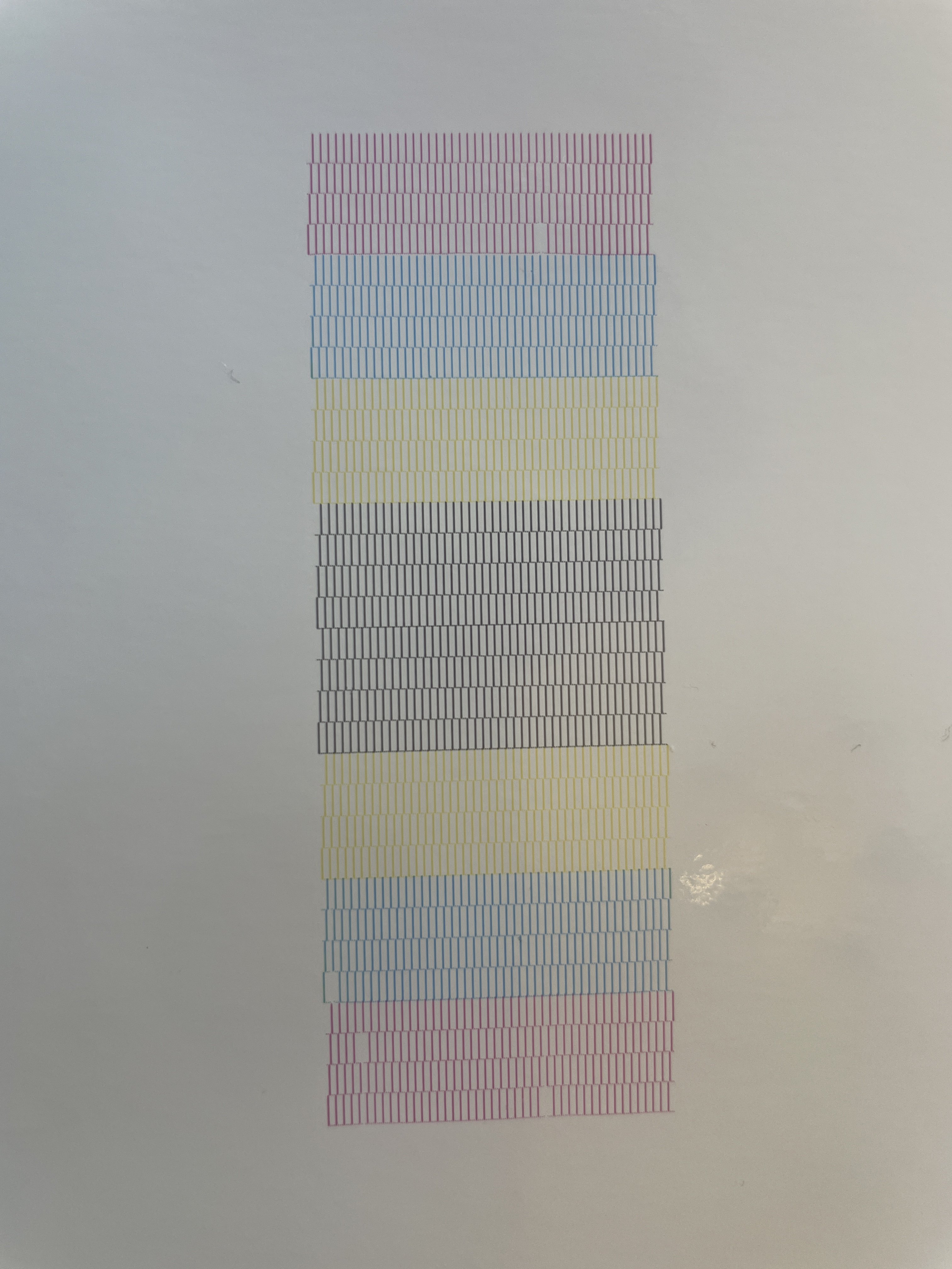

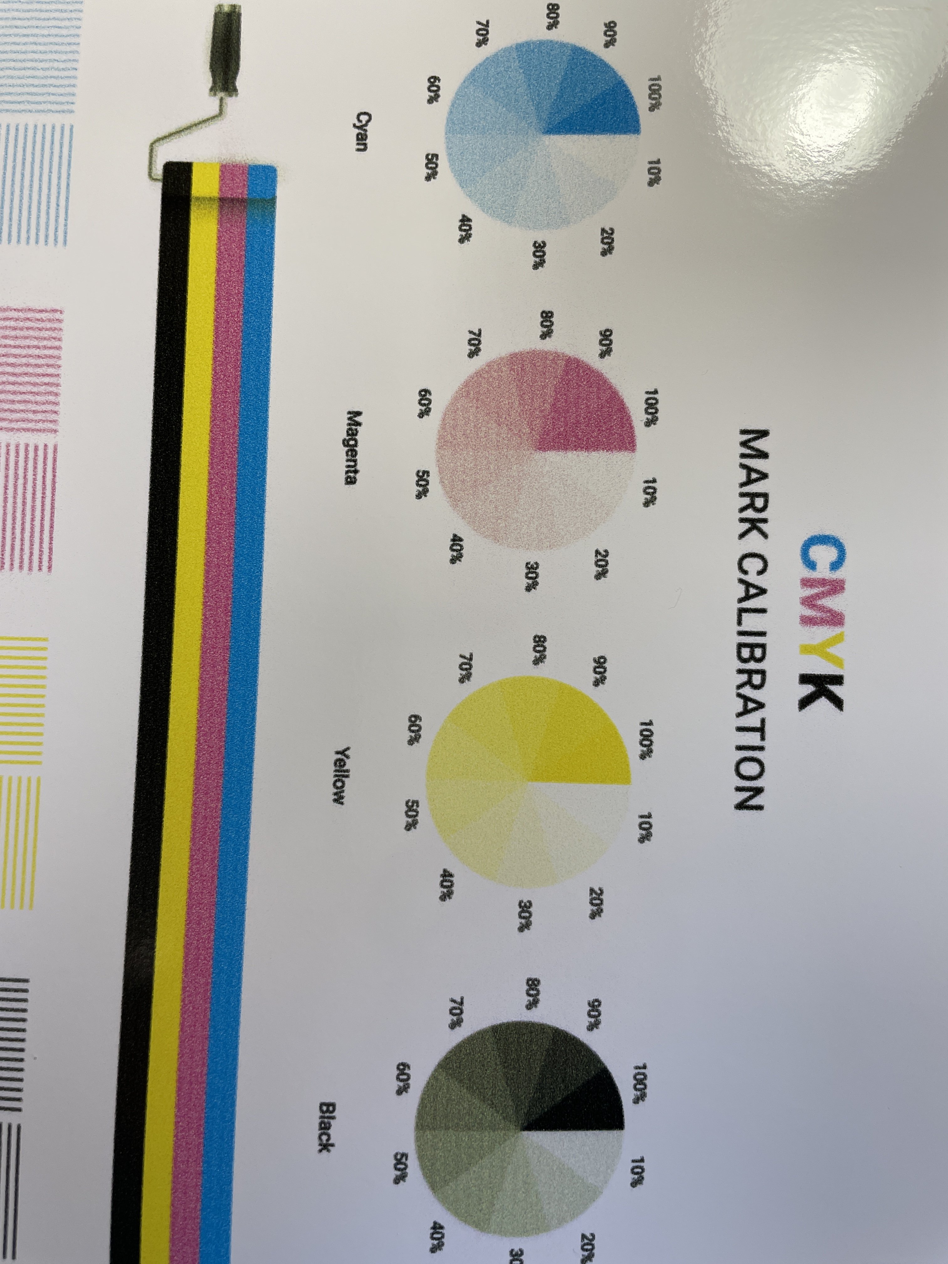

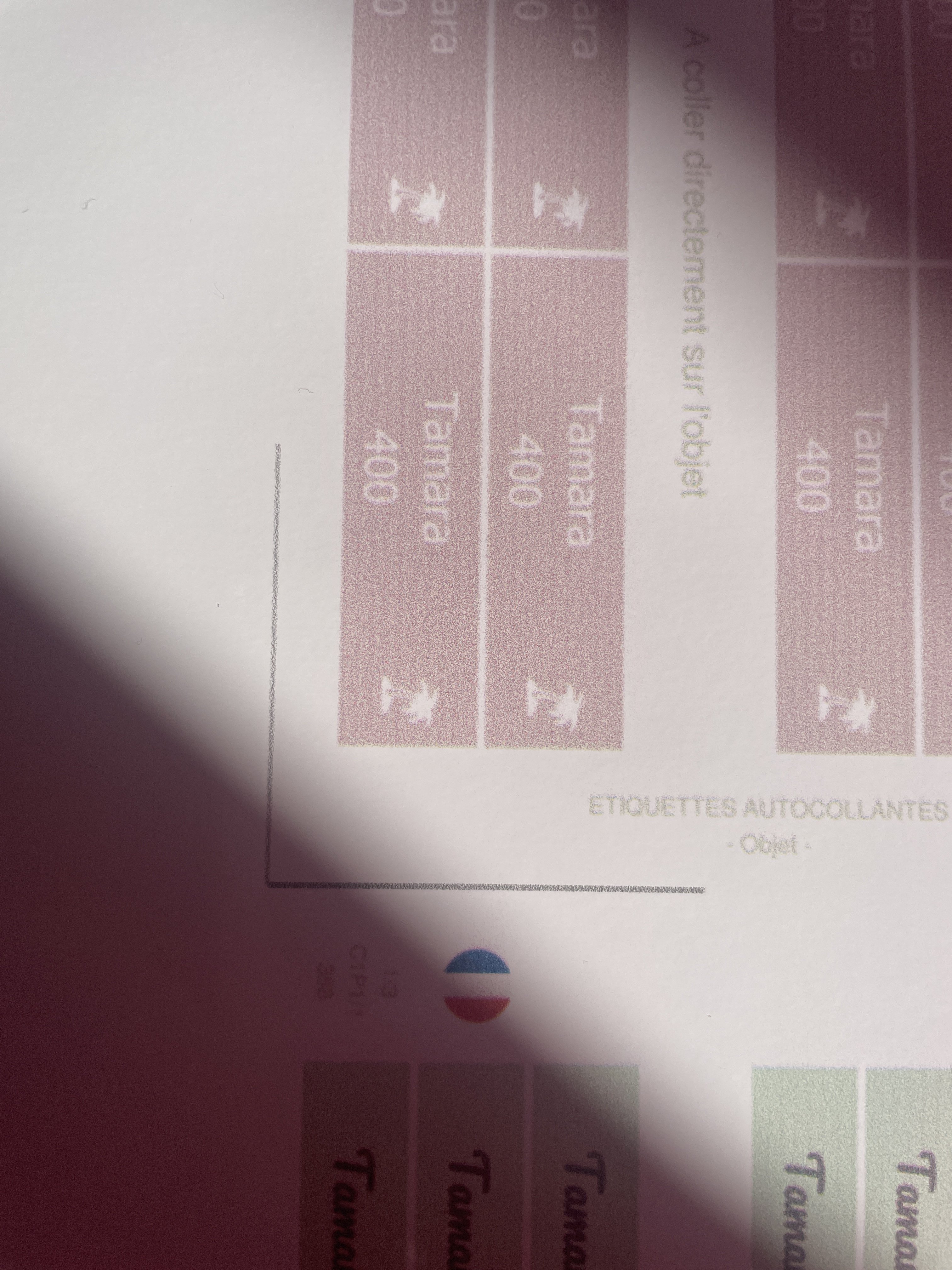

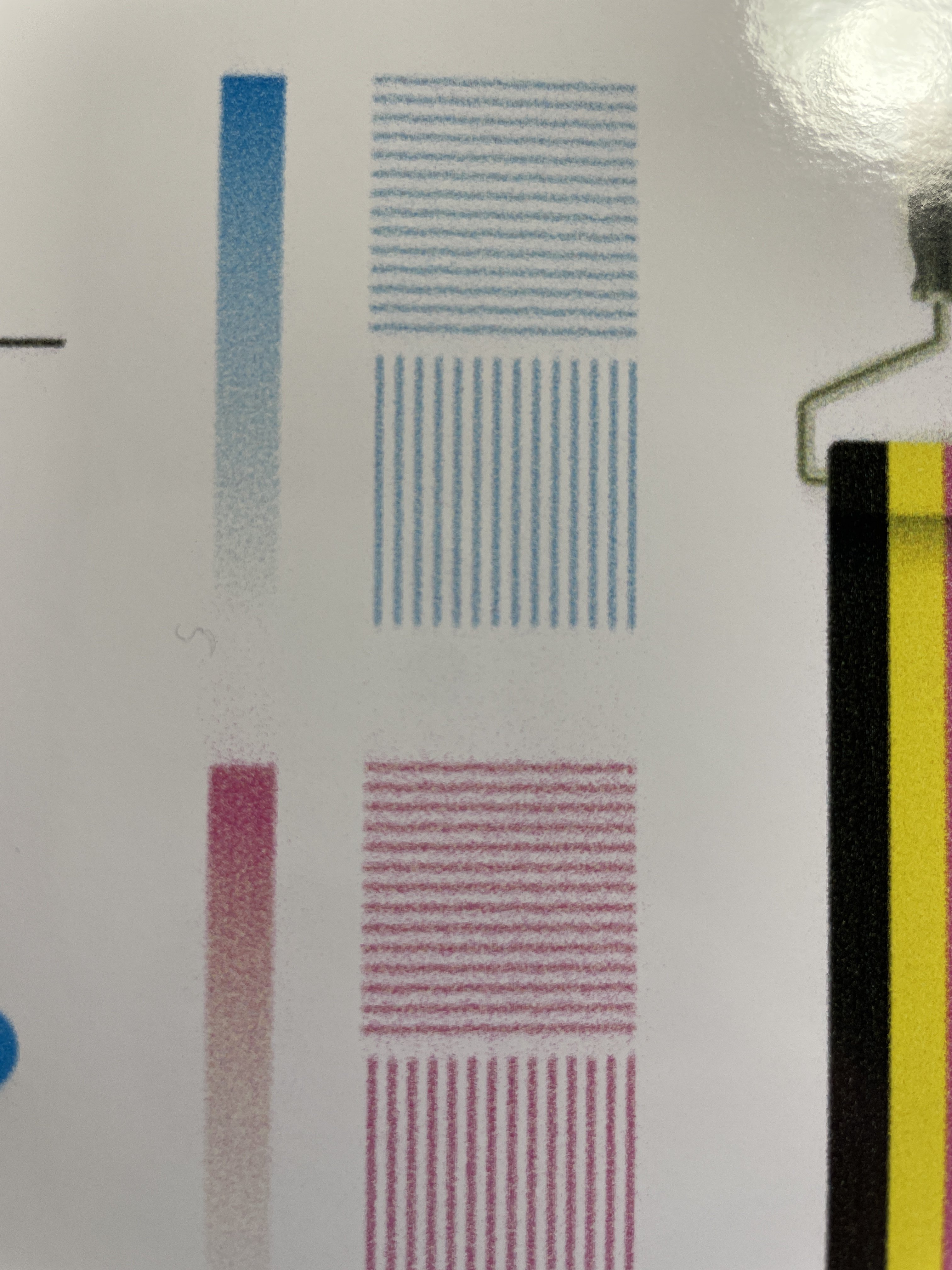

Hi,
I have just bought a 2 years CJV150-75
the print test is not so bad but when i print something it's awfull
i have clean encoder strip
make ink fill soft and standard
i print on vinyl
Is the head dead or something else
sbouey
Thanks for the feedback
i print for my test on Unidirectional and i have
and I settled the feed compensation
Smoke_Jaguar
Might be a MAPS setting issue or the head is using incorrect firing data. Seen this happen when someone bought a cheap replacement head and used the parameter chip from the old head to save a few bucks.
sbouey
it's in low position, i have set it to high but it's the same, i put it to low position again.
is there a way to see the position of the head in the machine to be sure ,the jvc see it in the right position
