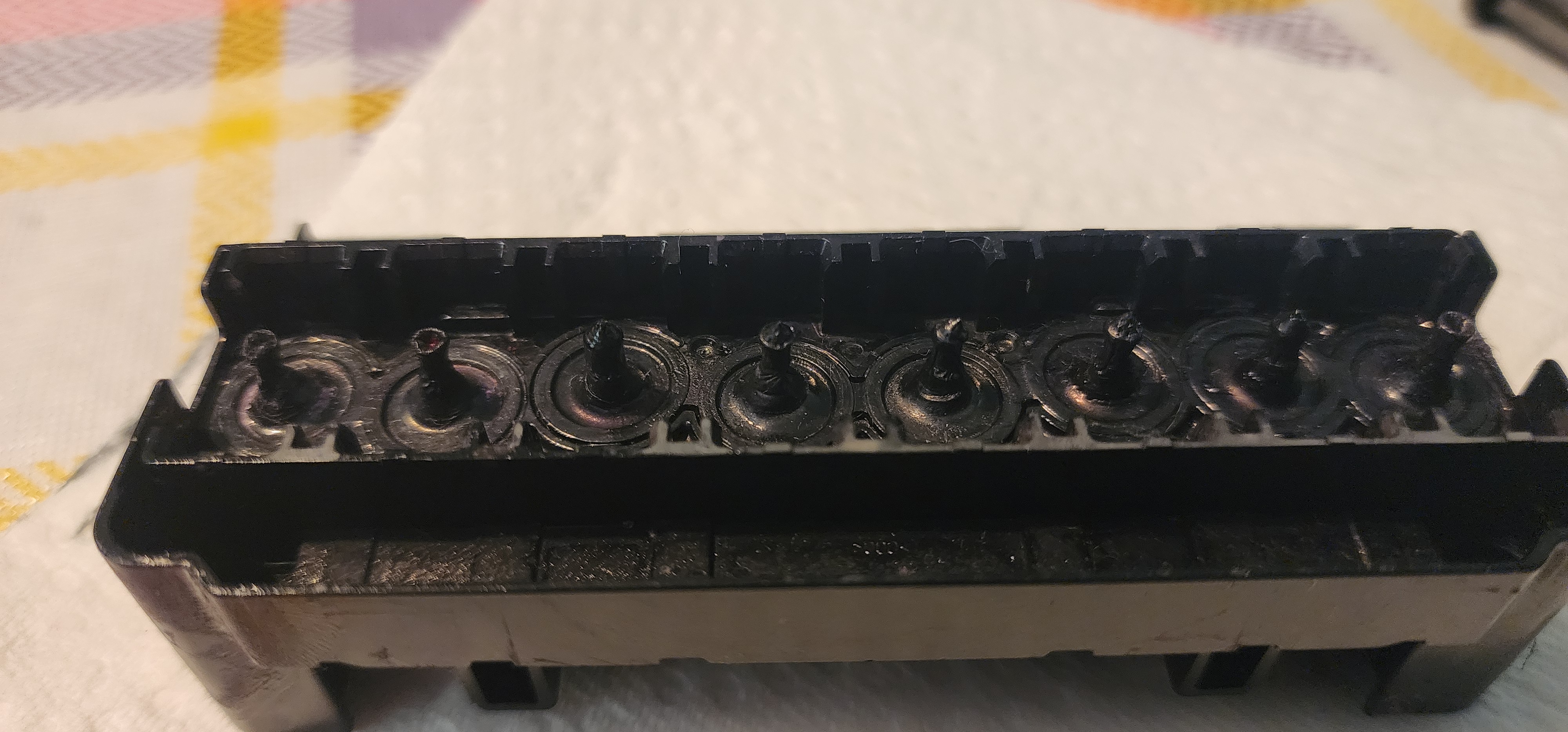

I did take the head out and soaked it while I was waiting on a new manifold to arrive.
The printer was flushed before being stored, with cleaning fluid. It appears that sitting and the time it spent, the cleaning fluid melted the ripples on the manifold.
Are there things inside the head that could have melted as well due the the cleaning fluid and time it sat? Putting it back together it's still struggling to pump up. Test prints I can't even get a speck of any ink to show up....
The maintenance fluid should not have melted the nipples or had any effect o anything in the head.
See if you can inject the fluid through each channel. Start by pulling to see if you can suck air back through first, then inject fluid in and pump slightly. If it goes through, try pushing a bit harder until you see a stream coming down through all the nozzles. Shine a light from behind to be able to see it well.
If the fluid goes through, you know the head should be able to work.
Then you can move on to why it's not pulling ink into the head. It's always the cap seal.
Check for blockages under the cap - put fluid in the cap and watch the tubes underneath as it does a cleaning make sure it drains away right to the end of both tubes.

This was the old manifold...
I ll try taking the head back out and working with it with trying to pull and push fluid.

Youch! I wonder if they used something harder like lacquer thinners?
You don't need to remove the head to flush it.
Take it to the left side and put a take-away container/tray underneath to catch the fluid
