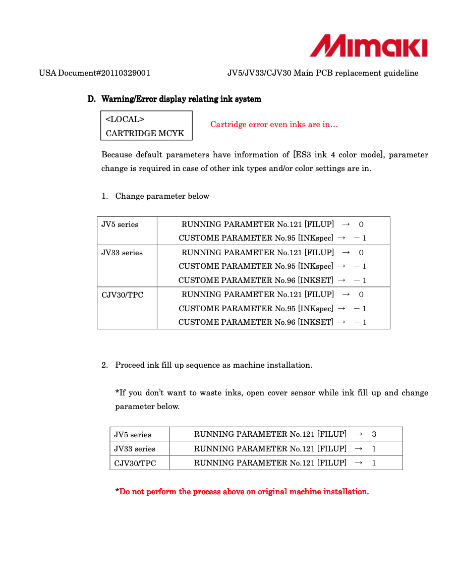

hiya, I'm trying to change my ink type in the hidden menu on my jv150-130, but when i enter the Parameter function> i dont have Runnin parrameters just SYSTEM param, Mainte, Servo, Feed, Head, Ope, Ink param 1, Ink param 2, Debug, Scan, nozzle, Hd1, then Wf3 and Wf4, i tried to search the [HASHTAG]#121[/HASHTAG] but no luck, can you help? thank you.
zapacituk
can someone please help, willing to pay!, i bought from easy inks some red chips for 2liter bags SS21, the previous inks was ss21, but with some green chips, and when I put the new red chips, gives an error and says ''ink type'', thank you.
You need change parametes, i attach photo
