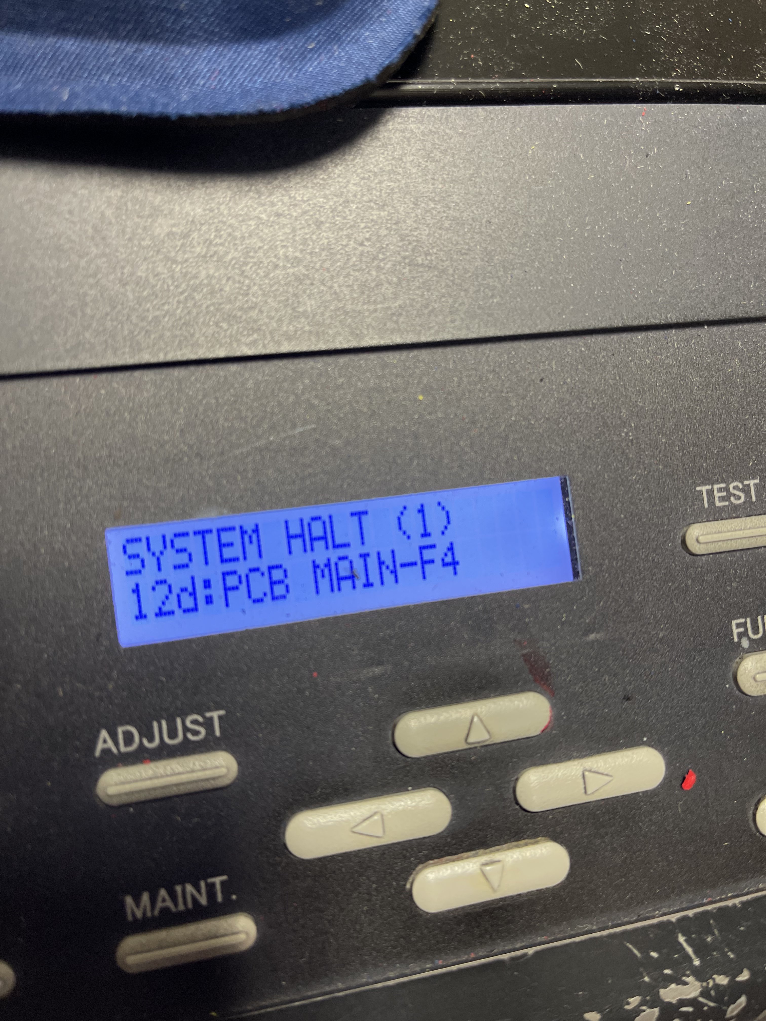

Was hoping someone had some insight to a recent error message we received on our JFX 200-2513. It's a SYSTEM HALT (1) 12d: PCB MAIN-F4 error message. Picture attached. I don't see anything in the error section of the manual. Any help/recommendations would be appreciated.
Yup. Popped fuse on the main board. Get a couple fuses and try to find the reason it blew in the first place as it's likely it will pop again. Usually it's a bad cable but it could have been a power surge.
