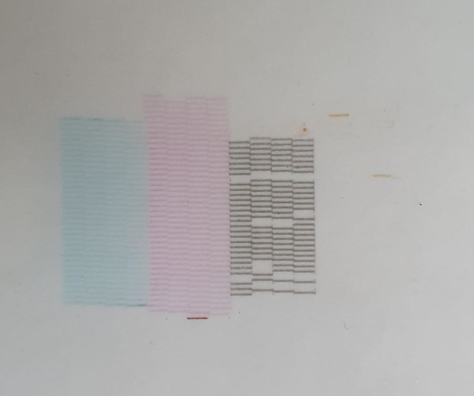

But here's my problem, whenever I start to do a job or a testprint I get the following error:
ERROR 187, HDC SLEW RATE [_2 ]
The thing is that I bought this machine for only 500 euros since it didn't work. Now I was hoping to get it running before I start investing in it. I don't want to spend thousands of euros to later find out that it's a lost cause.
I hope any of you have an idea of what it could be and what I could check. I already measured all the fuses and I checked all the flatcables. I didn't replace anything, like I said, I don't want to invest yet.
